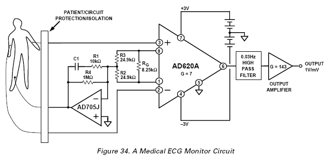

I want to build an ECG Front End system.
Base on Data Sheet of AD620 Figure 36.
I have highlighted in red square (Q1 – Q5) those items that I need clarifications.
For
Q1 Using battery it will solve ‘PATIENT/CIRCUIT PROTECTION/ISOLATION’
Q2 How to calculation for C1
Q3 ??
Q4 ??
Q5 ??
Appreciate if you can advise.
  • AD620.pdf
I answered most of your questions but I won't design the circuit for you.
Q1- Some ECG circuits use a 390k high voltage resistor to isolate each connection to the patient. The schematic shows that the circuit is powered by two 3V batteries and the highpass filter input coupling capacitor isolates the patient from electricity in the computer.
Q2- C1 is calculated with R1 and R4 to form a lowpass filter.
Q3- The batteries help isolate the patient from electricity.
Q4- The highpass filter is simply calculated as a coupling capacitor that feeds a resistance.
Q5- An opamp uses only two resistors to set its gain. A gain of only 143 times is easy.
