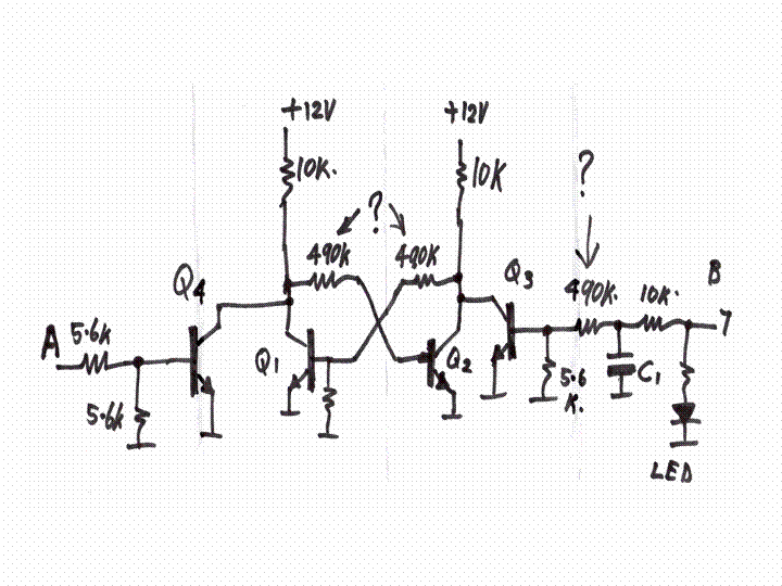

What´s the use of putting two transistor collectors shunted like the circuit in attachement! I don´t understand what this circuit does! Can anybody explain me? Thank you!

It's a simple logic gate, either OR or NAND, depending on the logic polarity used.
It looks like a "wired OR gate".
The collectors of Q2 & Q3 are low when one or the other (or both) transistor is on.
It can only go high when both transistors are off.
As I can't see the rest of the circuit, I don't know what the objective is.

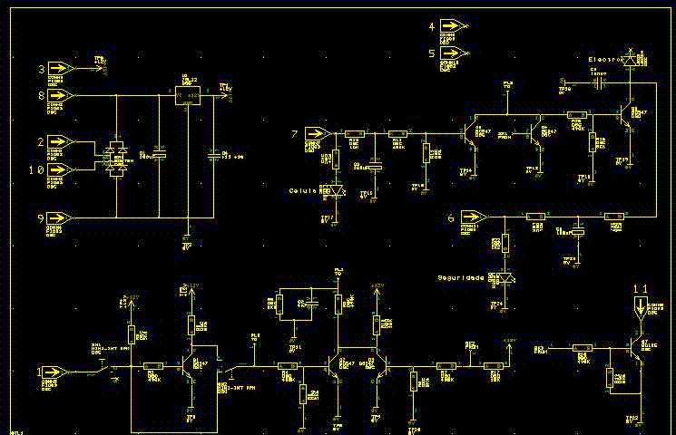

Here it is the all circuit...
Can you give me the circuits basic ideia?
Thank you...

The letters are too small to read.
Can you convert it to a .gif ?
Or partition it into larger sections.

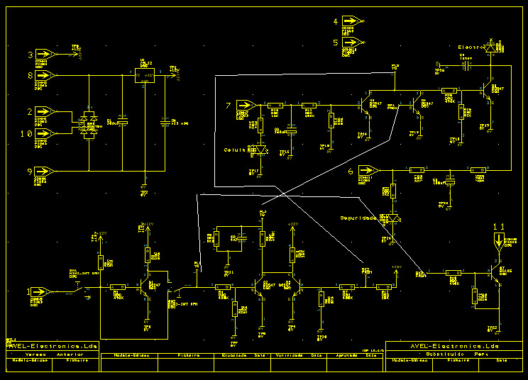

Hello.
Here´s the *.gif. If you can´t read please say I´ll convert into different designs.
Thank you

leonel said:
Hello.
Thank you
It doesn't help at all, because you've only converted the previous JPG to GIF, the JPG (as well as being far larger than a GIF) has already lost all the detail of the diagram, so converting the JPG to a GIF doesn't help at all. You need to start with a decent quality format, THEN convert it to GIF, any package should be able to generate a BMP (which is HUGE!), then convert that to GIF. I would also suggest you make the picture a bit bigger, even at good quality it's a bit small to see.
I agree with Nigel.
Len

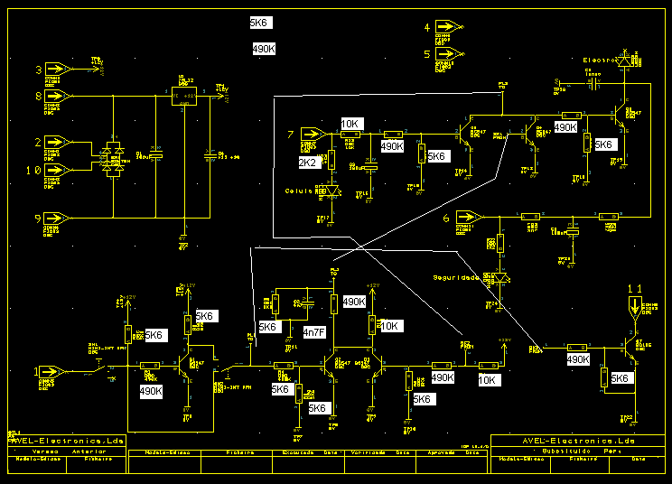

New schema
Here´s a new schema. My voltage regulator is 18V, and, almost, my resistances values are 490K and 5K6.
Thank you.
Regards

I put the resistances values... My transistor is BC547. If this helps... If it doesn't helps, that´s ok, i'll try other solution.
Regards

With the bases of a few transistors being fed from a 490k to 5.6k voltage divider, the input signal must be at least 57.5V for the transistors to begin to turn on. Where is such a high voltage coming from?
I agree with Audioguru. The "490k" resistors must be much lower.

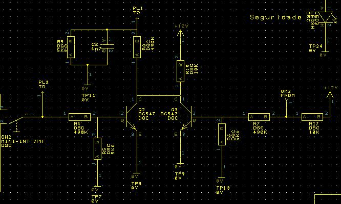

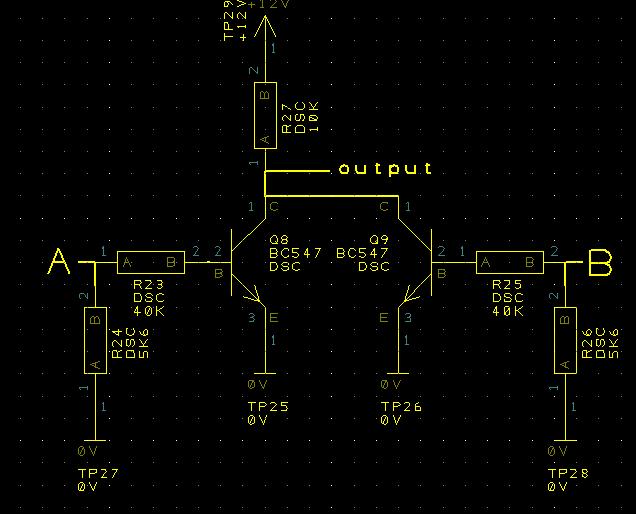

Confused
In the image i have 4 input possibilities
0 0
0 1
1 0
1 1
What´s the state of my output in each possibility?
I don´t understand if for example A=1 and B=0. With A my output=0 and for B my output=1. There´s a conflict between each transistor! It´s possible having this configuration?
Please help me... i´m confused.
Hi Leonel,
It's an OR gate with an inverted output. The output is low if A or B or both are high.
