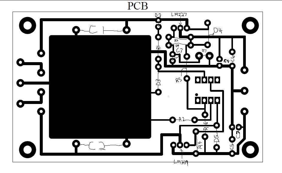

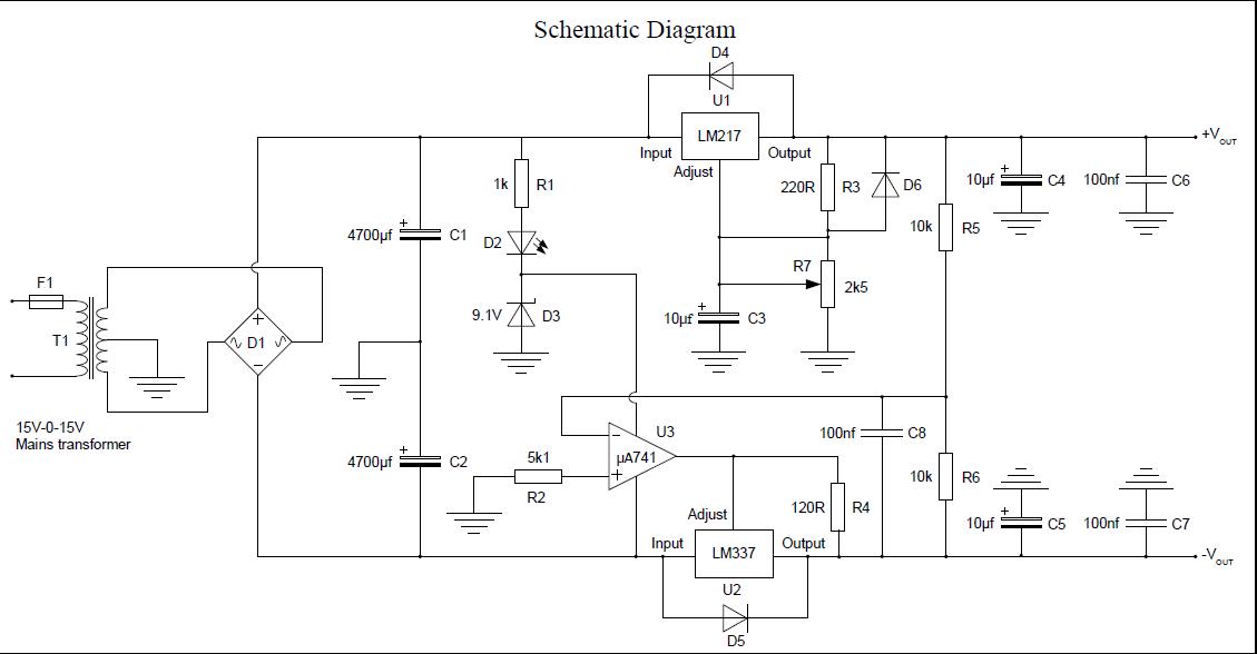

Hero I think I put the components right....but I cant see where the C8 would go? Sorry I know it's sloppy but it's the only way could get it off the pdf file you gave me. What am I missing here?

I suppose i should have prepared a silk screen layer, even though I didn't use it.
C1 and C2 are wrong, flip them by 90°, they're axial leaded and quite large.
I didn't fit C8 because I didn't need it. I was advised to include C8 because some people had simulated the circuit and it was unstable without C8.
Anyway, I strongly recommend you make your own PCB because the footprints of the parts you use may be significantly different.
C1, and C2? Are you sure those are the ones you meant to say? If I turned those 90 degrees where would they go?

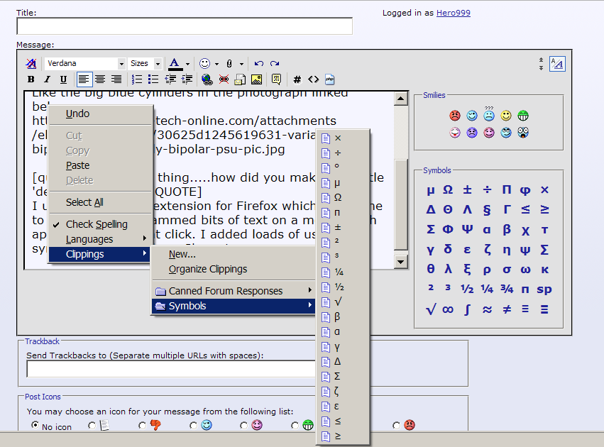

And another thing.....how did you make that little 'degree sign'? LOL
Yes C1 and C2.
Like the big blue cylinders in the photograph linked below.
https://www.electro-tech-online.com/attachments/bipolar-psu-pic-jpg.30625/
I use the Clippings extension for Firefox which allows me to access pre-programmed bits of text on a menu which appears when I right click. I added loads of useful symbols using Windows Character map. The forum also has it's own symbols but my list has the ones I use more often.
https://addons.mozilla.org/firefox/addon/1347
