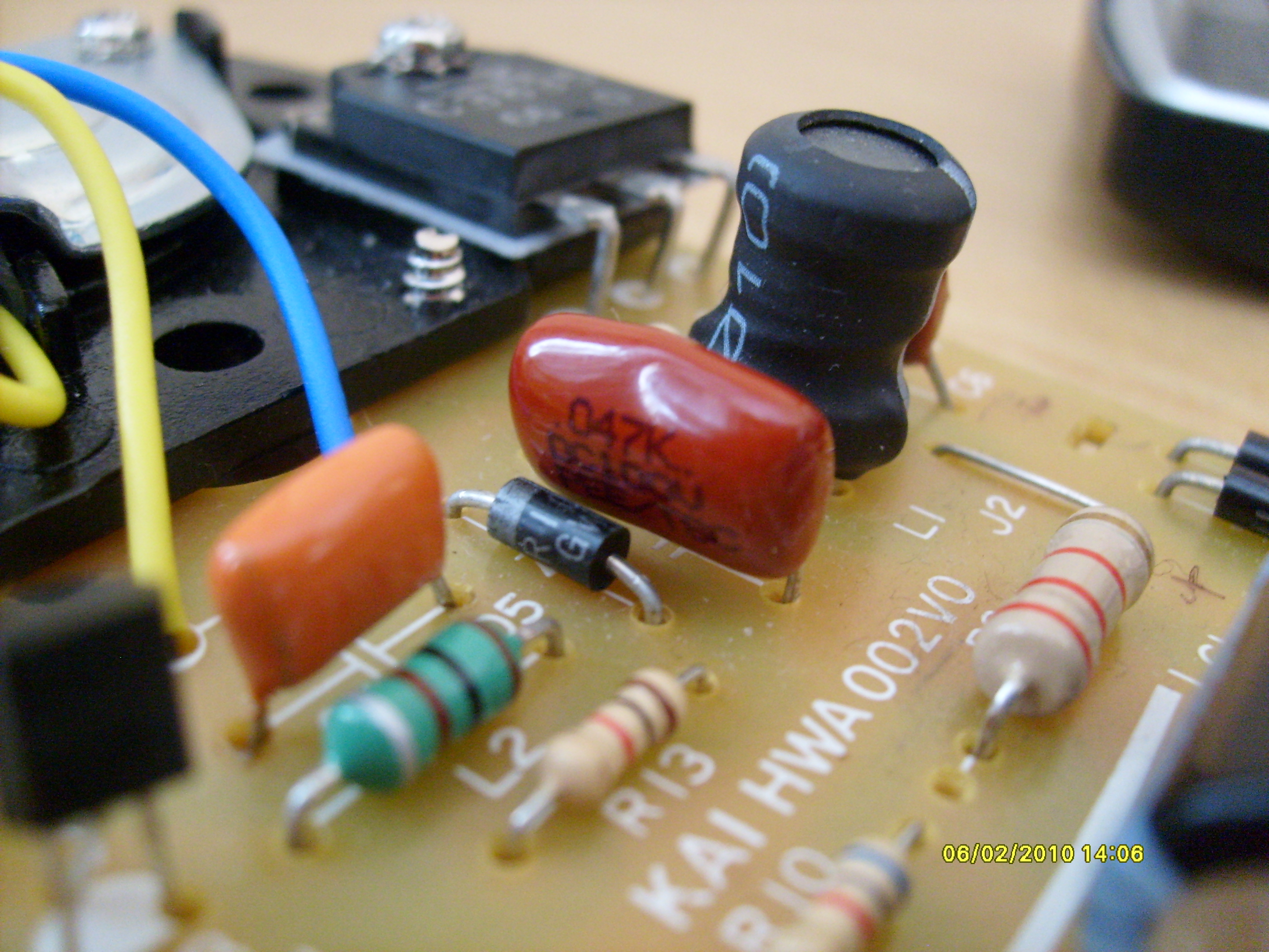

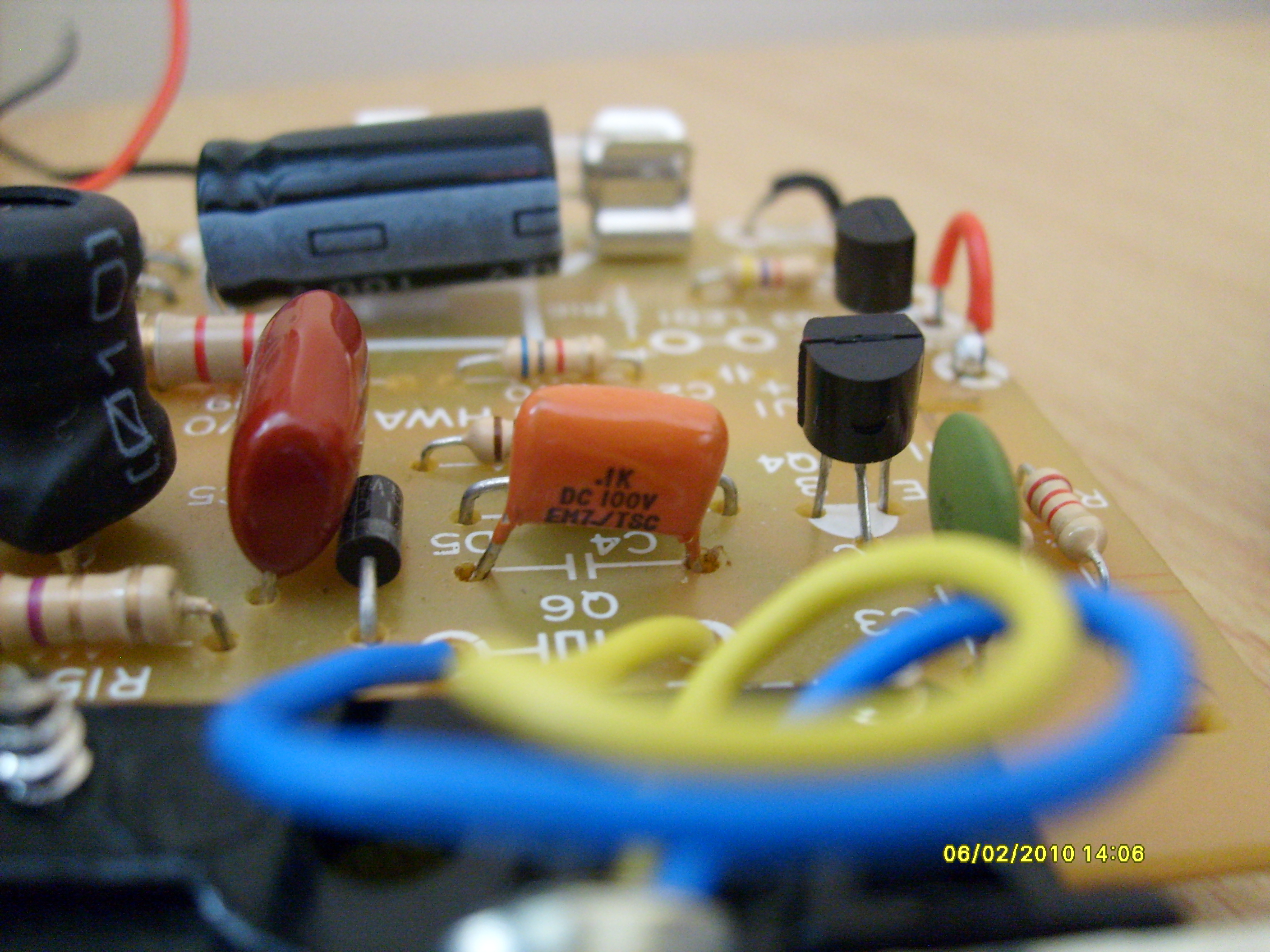

What type of capacitor are these?
antknee
I can only reliably identify two different types of capacitor, electrolytic and ceramic. I have two other capacitors that I need to identify. Which type are these?
The first is orange and measures on an LCR meter at 0.1uF. It is marked:-
.1K
DC 100V
EM7/TSC
The second is deep red and measures on an LCR meter at 47nF. It is marked:-
.047K..
DC 100V
PEE/TSC
Thanks,
Antknee

They are clearly marked as they tested 0.1uF (.1K) and 0.047uF (.047K).
They do look like polyester film. Also they are for use in a high frequency board, around 1.6MHz. Polyproylene is often used at these frequencies, I believe, and they look similar too. Hmmm.
