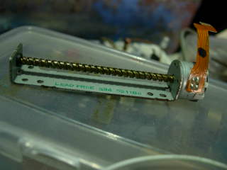

Can somebody please tell me what type of motor is this? I think it is a stepper.
What type of motor driver to be used with such motor??

Its out of a printer, moves the printhead with the helix on the shaft.
Most likely a 9V to 12V stepper, 2 windings, looking at the flexicable.
It's not from printer, friend; it's from a CD-RW drive...
In that case it moves the laser back and forth across the CD.

Its hard to judge the size of the object.
A good idea is to place a measuring rule alongside the object when taking the photgraph, so that we know the size of the object.
There appears to be 4 soldered connections to the motor cable.
It does appear to be a bi-polar stepper motor, from the laser positioning mechanism of an optical drive.
I have a few and haven't yet come up with a project for them, since they are so small.
I'll have a look for a datasheet for those I have to hand..
I think it's a bi-polar stepper motor.
This was used in positing the laser assembly to the disc surface.

BUT What is the piout of the connectors??
How can I get continous rotation out of that.

Datasheet linked in post #10
Controller...Are you familiar with PIC Microcontrollers? Do you know what a H-Bridge is? Have a search with Google. There are application notes on Microchip's site for the PIC16F684, which is well suited for this application.
What is the pinout of the connectors??
On your motor? Dunno. Assuming you have a DVM, check for continuity between two pairs of terminals, say pins 1&2 plus 3&4 for example. These pairs will be coil A and coil B.
You use the table depicted in the datasheet, to energise the coils in the correct sequence for the desired motor direction.
