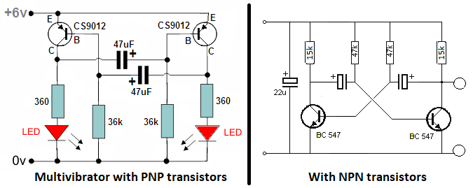

Hi. Please what type of astable multivibrator is this?
Thank you.

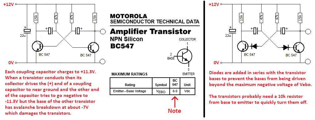

Thank you Sir. I just needed an astable multivibrator![]()
I am trying to test some circuits to see if I will be able to acheive a sine wave. I would add an RC on the output to try my luck. Its a PROTOTYPE. I'm just doing what I call "Testing the Microphone". If I need a sine wave, I would use An MCU instead of a multivibrator. And by the way, I'm gonna shape the output square wave from it using a single RC circuit. Hope it works![]()
