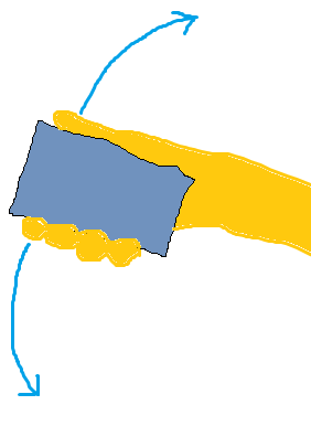

I am designing a small, "shake-sensing", amusement device. The user will need to shake it back an forth in front of them. The device needs to know if it's moving in one of the two directions, since it will light up differently depending on if it's in the "downstroke" or "upstroke" of a shake.
I am trying to find the simplest and cheapest way to achieve this.

an accelerometer would tell you in 3 dimensions which way the movement was and how fast it was moving in those directions, but thats probably not what you need for simple! you could make a simple device.
small tube. each end hot glue small pcb board on with a track cut in the middle, put small ball bearing in tube. the ball bearing touch's both sides of pcb causing it short (switch), so when you shake each time it hits one end or other it will act like a switch for each end. if hat isnt clear let me know I will try and post a drawing

What I have done is:
-Make a cavity in the plastic.
-Put in a steel marble/ball bearing/buckshot/something round and conductive.
-Bring from the inputs of the micro 4 stiff wires into the plastic cavity AND 4 ground wires.
As the marble roles around it shorts out one of the inputs to ground. The micro reads the inputs pins to detect movement and cruddy what direction and tilt.
ALSO
I have used 3 cavities. Long thin cavities running North/South, Up/Down and East/West. Each cavity has a single buck shot. Two input wires from the micro and one ground wire per cavity. Input 1 is on the North end and input 2 on the South end while ground is in the canter.
By looking at the data you can tell something about tilt and movement.
Input North is low, Input South is low, neither input is low. (and has this changed in the last 0.5 seconds)

You can solder a pen spring to a bit of veroboard, solder a weight on the free end of the spring, then just solder a couple of contact pins either side of the spring, with a connection to the spring and another to the contacts the circuit will close when the item is shaken enough to make contact.
Instead of contact pins you could use a piece of metal tube then it would respond in 2 axes.
