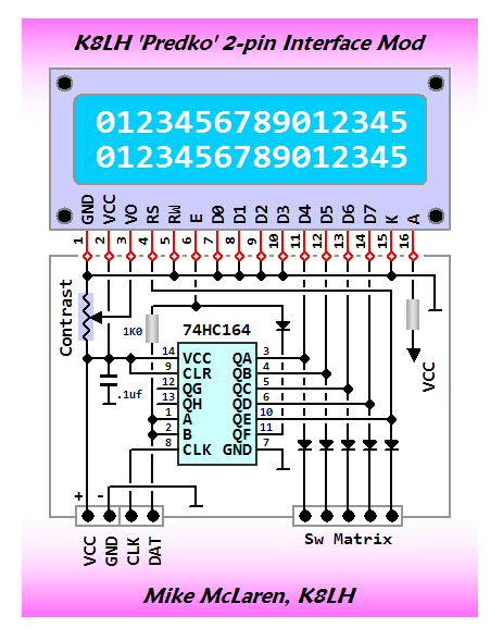

While using a small PIC for a "serial backpack" type LCD controller would use a more 'standard' software interface it might not fit your "easy to obtain" criteria. How about using a 74HC164 instead for the 2-pin Predko interface? It uses a custom driver but it's cheap and it can be modded to drive half a keypad which would reduce host pin requirements.
More food for thought, Mike
predko-mod-png.34825

I have a different view on those peripherals... The main thing I use a dev board for is to quickly develop things that will later be built as finished hardware to operate self-contained.
So the dev board needs to mimic the final hardware! If you use a 74164 etc to drive the LCD then all the finished hardware devices you build must also use a 74164 and all the extra wiring. I think it's so much better to have the LCD connected to 6 PIC pins on a common port (like PORTB) then all you need to do to make a finished app in hardware is copy the 6 wires that are used on the dev board.
That's also the reason you need a LED for every PIC pin, it doesn't matter what final hardware will be connected to that pin; like a solenoid, light, PWM motor etc, if the dev board has a LED for that pin you can still develop the app completely and you know it will work when built on the final app hardware later. Likewise one pushbutton for each pin.
