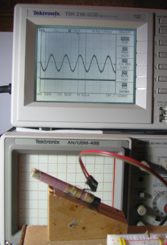

I am building a LW receiver/amplifier like this: https://sidstation.loudet.org/hw-en.xhtml
My Max 275 filter (https://www.maximintegrated.com/en/products/analog/analog-filters/MAX275.html ) will arrive (I hope) Monday. I have added some small capacitors (8.2 to 22 pF) across the TL082 op-amps I am using as low-pass filtering. With just three stages ( about 60 dB gain) I am picking up something strong around 100 kHz. My target (center) frequency for this project is 250 kHz. Attached is a really crude LT Spice schematic that shows a close approximation of what I built. Some of the resistor values were changed to accommodate what I had on hand. The capacitor values are what I used.
What could it be? Location = NE Ohio about 40 miles West of Cleveland. My first assumption is it is some sort of oscillation that I will need to deal with. But just in case someone knows of a LW beacon in the area, I thought I would ask.

On further investigation (I fixed my antenna and used the shorter of the two coils), I believe the frequency is closer to 53 kHz and comes from my Tek TDS210 scope. It is quite strong and directional (saturates my "receiver"). Here it is this morning:
Here it is after partially shielding it with the hat I wear ;) :
Can't wait for my tuning IC to come tomorrow.

UPDATE: The 'scope has a 47 uF/450V capacitor for the screen backlight power supply. It read about 1.5 Ω, but was very slightly puffed. I replaced it with a new cap (ESR = 0.53 Ω), wiggled the copper Brillo pad connecting the case to ground, and it works fine now. Noise on the signal channels is a little now than before, and I don't detect the interference at 53kHz.
