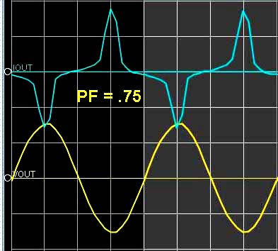

The attached picture is of a power supply like in a PC or radio. The current has a very high peak and is not sign wave!
The power company wants a PF=1.
In the case of the picture the current is much higher (PK) and the resistance loss in wire is more. You can only get about 10A average through a 20A breaker. Same problem with wire heating in the walls. 10A not 20A The power company has loss in the lines that they don;t charge you for.
If you have a motor the current lags the voltage. It is hard to deliver power when the current and voltage peak ARE at different points in time. So the power company might have to add capacitors to correct for the phase shift.
With the push for "green" we have to make large devices have a good PF. (TV and computer)

Hi there Billy,
Most circuits do not 'need' a power factor, they end up having a power factor because some of the load is reactive which means it stores some energy and dissipates energy while a purely resistive load (power factor 1) does not store any energy.
So that's the main difference. If the power factor is less than 1 then the load has capacitors and/or inductors in it as well as resistors. If the power factor is 0 then it only has capacitors and/or inductors and no resistance to eat up any energy.
So a little table:
PF=0, no power dissipation, capacitors and inductors only.
PF=1, no reactive elements like capacitors or inductors, resistive only.
Between 0 and 1 but not including 0 and 1, there is some reactive and some energy being dissipated.
So a PF like 0.7 means there is some energy storage and some energy dissipation. We can use math to figure out how much of each.
