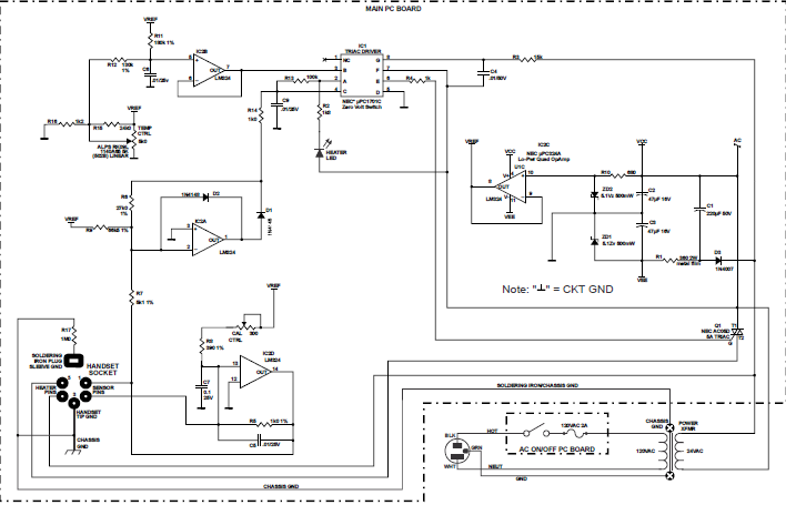

I have assembled a constant current source using an LM317 but the schematic was described as a disaster but why??
It appears to work as planned. R1 in my circuit adjusts the ADC for the RTD temperature sensor.
My as built schematic is the one on the right.

The circuit is supposed to be a constant current source. The value of R2 should be adjusted to change the current.
Adding R1 allows the constant current source to saturate (like two diodes in series with R2) so it is not a constant current source anymore.
I don't want to be able to adjust the current, just the output voltage as it is connected to the RTD/ADC input.

A constant current source keeps the current constant by adjusting its output voltage up and down.
If you want the output voltage to be constant but adjusted by you then remove the constant current source and replace it with an adjustable voltage reference or adjustable voltage regulator.

It is. The LM317 has a minimum current draw of either 5mA or 10mA depending on which version. You can't set up a design which only draws 1mA or it will not work right.
So in other words I need to use lower resistance on the LM317 output to obtain a draw of 5-10ma. But then need to worry about self heating of the RTD?

No, the LM317 is fine. Try this:
Just ditch R2, replace R2 with R1 (probably don't need R3, but leave it for now and see).
Then tie the juncture of R1 and R3 to the A/D input on the PIC.
Adjust R1 for appropriate output of RTD at a known temp.
Remember that the LM317 has a minimum load current of around 3.5 to 10mA: less than that will result in squirrelly values from the RTD.
Don't know what RTD you're using but there ought to be info on it's response to current versus heating.
That ought to work.

Interesting circuit I found
This I found searching the web. It is in the lm324 data sheet.
The output is very low current .
thinking of using the lm317 as ref voltage of maybe the pic has a ref voltage source (more research).
this circuit is very similar to the one that the Hakko soldering iron uses.

Using the LM324 and Hakko schematic
I may have stumbled on the circuit I can use and I have all the parts on hand.
RTD resistance = 50 ADC input = 624mv Current at AM1 = 831ua

R3 in your current source circuit is supposed to have a constant voltage across it so it can create a constant current. But you have its voltage and current being changed by the pot. So connect R3 directly to the +5V regulated supply instead like this:
Ah yes I see where my mistake was. Wasn't thinking at 11pm last night.
now to figure out a better constant voltage source seeing how the Vcc powering the rest of the circuit may vary some maybe? or just don't worry about it.
If you use a 5V regulator IC and the load current does not exceed about 600mA then the 5V will not change.
