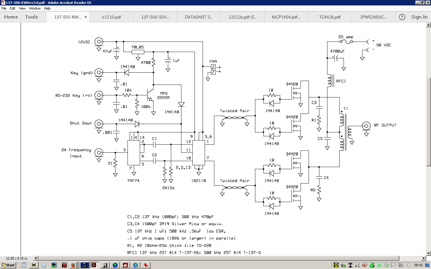

What's the function of these caps and resistors please?
What might these resistors and caps do in this schematic please?
In this schematic of a 136kHz Class D amplifier, do C1 and C2 with their associated 15k resistors add some sort of delay or what? Thanks

The 7474 outputs a square wave, C1,2 and the 15K convert the square wave drive to a differentiated pulse for the IR2110 inputs.

Hi Eric, thanks for the reply. Newbie alert, please expand on "differentiated pulse" please!! :) Does this mean they introduce some external dead time reducing the chance of both FETs ever being on together? I am finding the signal level with the 1000pF caps is very low at the driver chip, only JUST enough to drive it reliably. For example, if you just touch pins 10 or 12 on the IR2110 when running the waveform to the gates goes berserk and stays that way. I found out by accident, then looked at the levels. Before C1 and C2 the levels are fine. Thanks again.

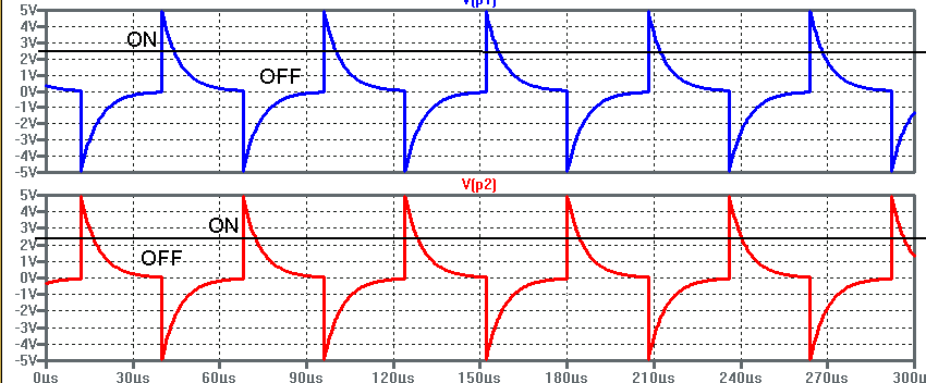

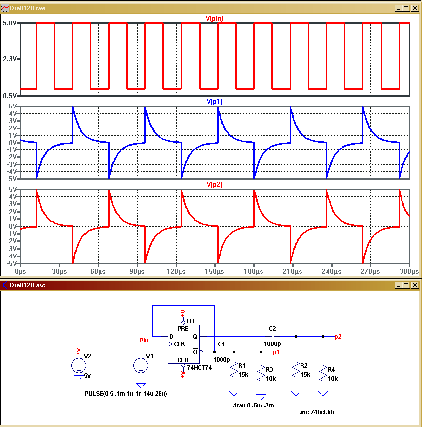

Look at this simulation.
P1 and P2 are the inputs to the IR2110
E
E
OK, thanks a lot for taking the time and trouble to simulate this, I just had a look on my scope at the inputs to the driver and there's a good similarity in the traces, I am impressed!
But in my naivety I have to ask just what do you believe the designer's intention was with these? Are they to add a period of dead time between switching the push pull output FETs, or what? I see capacitively coupled driver to gate configurations to stop a faulty signal holding a FET permanently on by blocking DC, but this is the first time i have seen caps *BEFORE* the driver IC. Thanks again, and thanks to AnalogKid for the Wikipedia link :)
I would say that is the intention, so that both High and Low FET pairs are not ON at the same time at the switching edge.

Assume that the IR2110 detects a 'high On' when the input signal is at say +2.5V and above level, the other input will be lower than 2.5v and can be considered as Off and Vice Versa on alternate phases.
E

The pins 10,12 are sensitive to the drive level of 74F74 since TTL only sources 2.5V @ 2mA ( yet sinks 20mA~0.5V).
So if you are using these obsolete TTL chips a 470Ohm pullup on pins 2,6 and 5 of FF are needed. Then the C1,2 values may need to be reduced.
Also pin 11 is high impedance and touching 12 or 10 with 11 shuts down the chip making the signals haywire, soa pull down R of 10K improves immunity on pin 11 (SD); (>100k to gnd internal)
But if you are using 74HC74 then you should be getting 5V positive pulse with the negative pulses clamped by internal ESD diodes.
So this design has some minor flaws or sensitivities.
The intent is to drive the FF with 2x frequency then divide by two using Qbar to D feedback to get near perfect symmetry square wave.
Each complementary output is differentiated so the rising output edge is the only active time each driver outputs are ON thus controlled by the RC decay time and thus the dead time, between one input going below Vih threhold to Vil and the other input fast rising edge.
Dead time ~0.5 us or so is typical and depends on power driver RdsOn and hence Coss. turn off delay.
1000pF and 15k yields a 15us time constant but since the threshold is near Vcc/2 it switches much earlier than this time constant for low pulse heights. This is not a precise method of deadtime control but I suppose can be made to work.

Eric, thanks for the revised simulation, again, appreciated!

Hi again CW,
back to your original question about the Rs and Cs.
The resistors and capacitors form differentiators with a time constant of R * C.
The time constant is so long relative to the signal coming from the 74F74 that differentiation will not take place at the signal half periods, so the R and C combination will neither speed up or slow down the signal. They will simply make the mean level of the signal feeding the MOSFET driver zero volts (DC blocking).
But what the R/C combination does do is to switch off both MOSFET pairs, after a delay proportional to the time constant, if the clock input to the 74F74 is absent for any reason. This will protect the MOSFETs, transformer, and possibly other components, from excess current.
Why should one of the MOSFET pairs be permanently on if the signal were missing. The 74F74 has only two states and in one of those states, either Q or /Q output will be at a high level so, if the outputs of the 74F74 were directly coupled to the MOSFET driver inputs, one of the MOSFETs would be permanently on.
Why should a permanently on MOSFET damage itself and/or the transformer. A transformer has a primary inductance and is similar to an inductor. It is a characteristic of inductors that the amount of current flowing through them is dependent on the voltage across the inductor and the time that the voltage has been applied.
For example, if you had a perfect one Henry inductor and applied one volt across it from a perfect voltage source, the current through the inductor would increase linearly from zero amps at the rate of one amp per second without limit. So after an hour, for example, the current would be 3,600A.
But there is a further problem with practical inductors (transformers), after a certain current in the primary the core will saturate and you will no longer have an inductor but a piece of wire with a relatively low resistance. So, when the core saturates, the current shoots up and inevitably destroys some component, normally the transformer and/or the MOSFETs.
spec

By using the second gate input on the 74HCT132, it would be possible to inhibit the clocking source to the 7474 during power up.
Eurika- that is probably the main operational reason for the Rs and Cs: to protect the circuit during power-up when, initially, the signal may not be present.:)
spec
The signal to the IR2110 will always be present at power up, dependent on the state of Q or /Q of the 7474, at power up.
That is the purpose of the AC coupling from the 7474 to the IR, via C1/2
