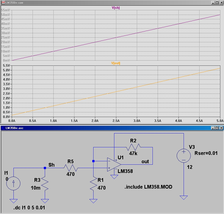

Even the old LM324/LM358s have a common mode input range from (Vss-0.3) to (Vdd-1.5V). They can be used to sense the current in a grounded shunt without using a negative power supply.
I wasn't aware of that. Nice to know for the future. Will make my life a bit easier. And just for clarification, 'cause I don't really know. Did you really mean Vss-0.3. If that's true, I'm really impressed.

Yes, I meant 0.3V below ground :D. Download the spec sheet **broken link removed**, and read note 10.
So just use a rail-rail single supply op-amp like the opA364 from texas instruments (really dual supply works too and makes no difference. Just make the difference between ground and +V the same difference as the voltage potential between the dual power supply). WIre it up as a regular non-inverting amplifier to feed into your ADC. Bam! Done!
Sounds simple enough. I can handle op-amp design, I've done a few of them. Suprisingly enough, most of them worked.

Here is a simple sim I cobbled up:
