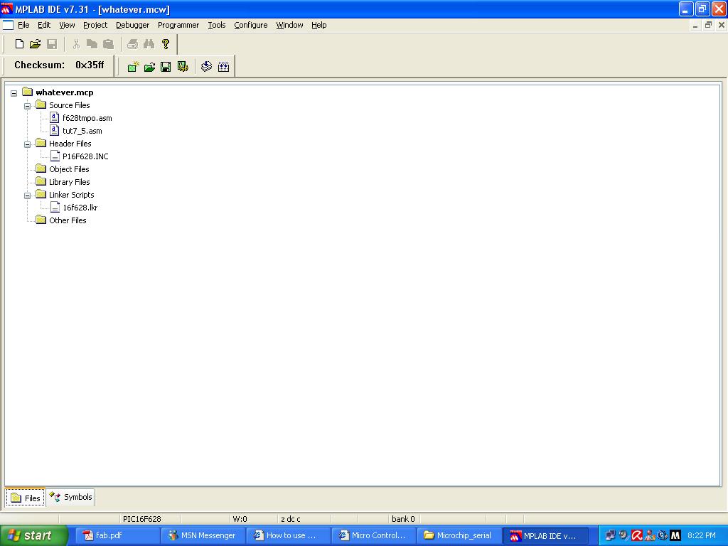

Ive tried to build a project in MPLAB and got the following error
PLINK 4.02, Linker
Copyright (c) 2006 Microchip Technology Inc.
Error - section '.config' type is non-overlay and absolute but occurs in more than one input file.
Errors : 1
It's my first project in MPLAB. I checked MPLAB's tutorial I added the following files:
Header files : PIC16F628
Linker scripts: 16f628.lkr
source files: f628tmp.asm + tut 7_5.asm
this how my work space looks like:

I just had that. I believe it means the declarations for fuse bits (oscillator type, brownout detection, etc) have been found a second time. Also it might be for EEPROM data but I don't think so.
Either you have 2 files like this, or more likely you have one file getting compiled twice. Most likely is you did the declarations in a header (*.h) file without protection against repetition and included it in more than one *.c file.

ok sorry I thought you were doing C. But it may be a similar prob.
Look in the other place you asked this question. I think it is that your code is assembled in absolute mode, rather than relocatable. You should probably remove the linker file, or lay out your code as relocatable.
