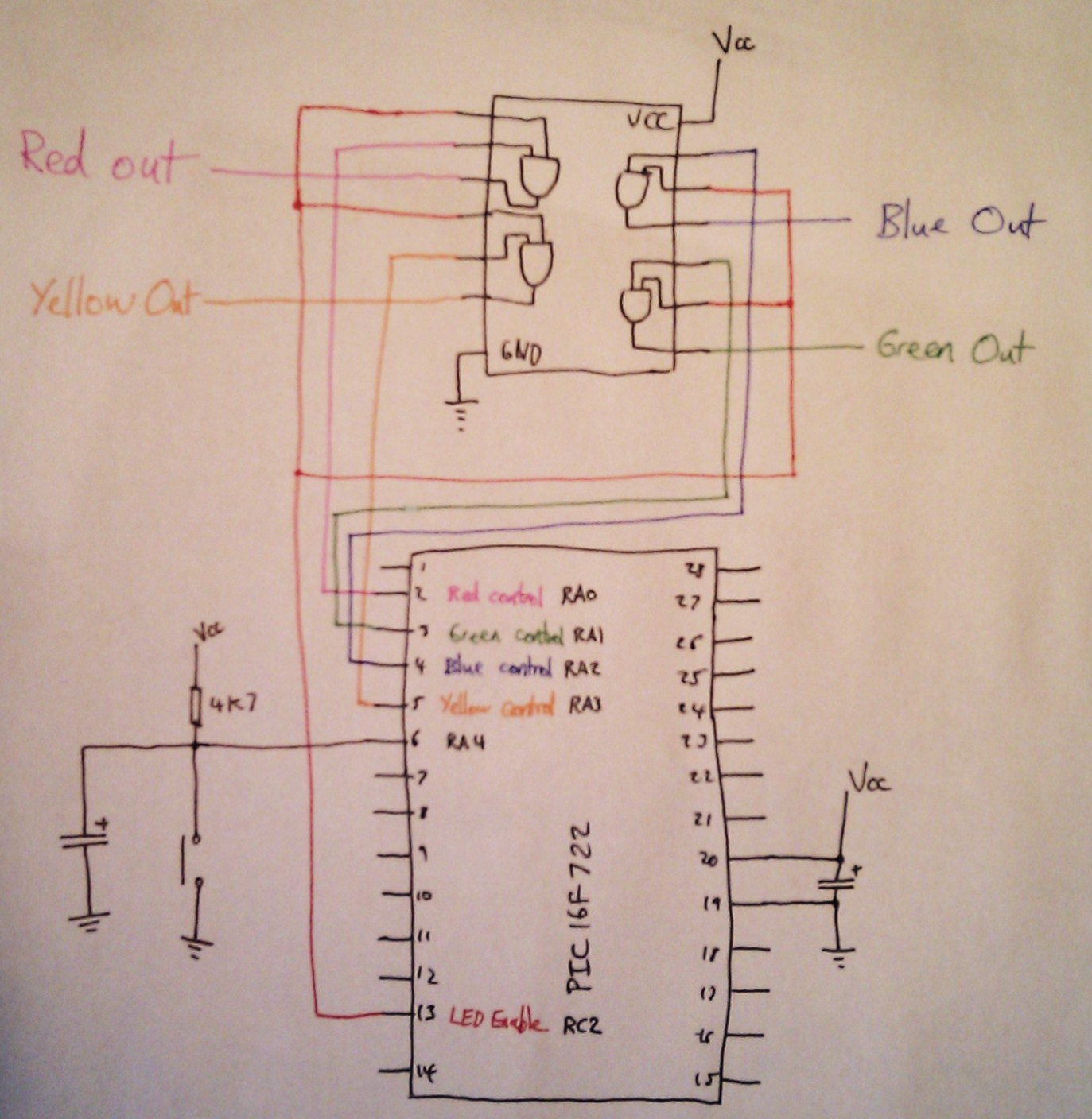

This board.
No schematic is provided, but it is the PIC with five of the outputs feeding a 74HC08 AND gate. I've drawn out the schematic, and it is really simple.
Can you post that scematic ?
One thing i see is that you've selected the HS oscillator in the config word, but i don't see any crystal on the board ?
The HS setting is for a high speed crystal oscillator.
Here's the schematic (plus a 15K pullup on pin 1).

You'll also have to change the config word to set the MCLR/RE3 pin to internal MCLR operation.
This is the reset pin OR RE3. The config word chooses what it will be - if it's set to reset function and left floating like on your scematic the pic will go in and out of reset randomly.
Many thanks, Exo - now I can try and start to get this working.
