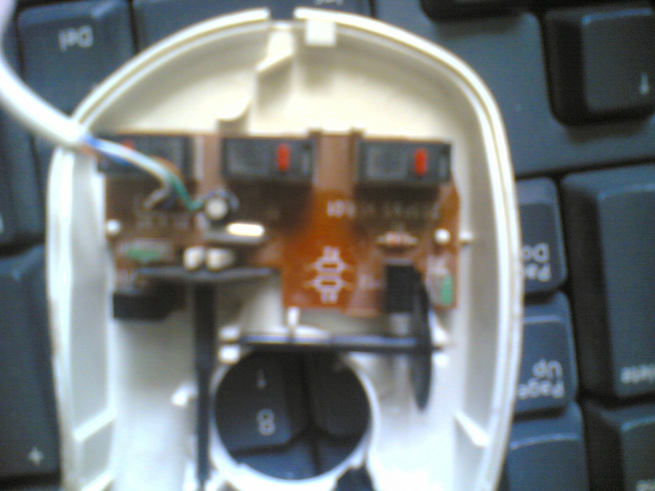

opened up an old wheel mouse. a wheel with perforations is revolving and a photo-transistor, led pair sense the gaps and closed portions of the wheels. how does it get to know in what direction the mouse is moving? i mean the direction of spinning of the wheel.
please anybody who knows tell me.

It is probably a quadrature encoder. Each LED has a detector across from it and the wheel spins in the middle. The gaps in the wheel cause the detector to see flashes of light, either dark or light (0 or 1 is what is seen digitally)
Notice you have an LED pair? That means you have two light-sensors, one to go with each LED. Each emitter/detector pairs is positioned 90 degrees out of phase. This means that if you take the current value of each detector (light/dark or 1/0 in digital) and compare it with the pair of values from the last reading you can tell the direction it is going because the values are unique.
For example for a motor (or wheel) spinning:
Constantly spinning clockwise
Detector A: 101010101010101010
Detector B: 010101010101010101

no i didnt. its still working only the circuit and wheel. thats why i am surprised. i tried passing small wires though the gap, still it senses the direction correctly. i am amazed...
If it was a quad encoder the wire might not do anything noticeable by you since you would have to hold it so perfectly to block any light from getting through the slot while moving the mouse.

the mouse i am seeing is actually having only two buttons, no scroll wheel. it is a ball mouse. the wheels are for encoders only.
The HowStuffWorks article says there should be two LEDs per wheel. Makes sense for what I said, but not for what you have...
How many light detectors are there? Because there HAS to be four if it's a quad encoder (I can't think of it being anything else the way you described it). It might be that instead of using two LEDs per wheel, one LED is used from behind a barrier with two pinholes that are positioned 90 degrees out of phase, to simulate two LEDs thare are 90 degrees out of phase.
here's the pic. only one led, no barrier also. what do you mean by 90 degree out of phase. you mean ac supply is being given to leds?

I can't see stuff in your picture too clearly, except that does only seem to be one LED per wheel.

you saw the pic. did you understand how it works. the receiver is a phototransistor(thee terminals) and there is only one led....
Yeah...sorry I still don't get that. The only way I can see a single LED/emitter per wheel is an absolute encoder wheel where each segment is unique. But you say yours is slotted the same way all around.
samarsingla said:
but there is only one led receiver pair per wheel..
We've been through this on a previous thread!, it has TWO sensors per wheel, although many modern ones have them built in a single encapsulation so it's not obvious.
could you please elaborate on that a bit more. do you mean two leds and two photodiodes or something. please explain or giv me some link to follow. thanx
