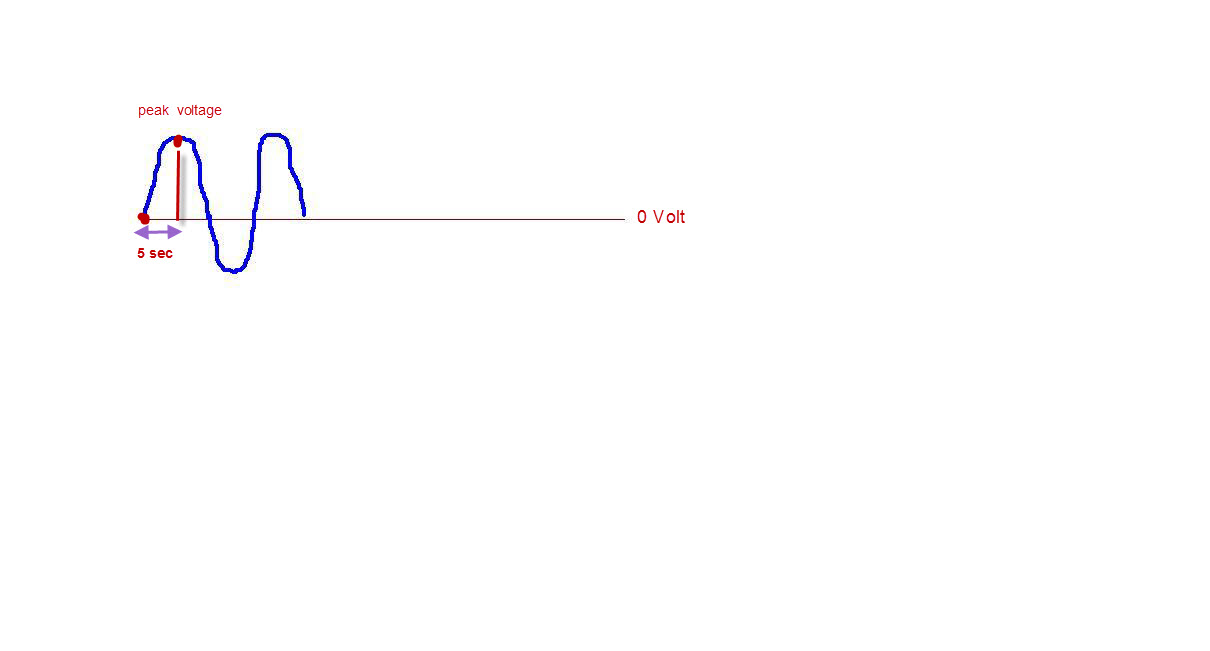

Let's talk about the capacitor a little more. I do have made some progress!
When a battery is connected to a capacitor an instantaneous current flows into the the capacitor. Now how much current (which is charge per unit time) flows into the capacitors depends on the capacitance of the capacitor. If capacitance is large, then it would take more current (hence charge) to reach the state where voltage of the capacitor counterbalances the voltage supplied by the battery.
A battery is also limited by a maximum current it can supply. Suppose we have two batteries which can supply the same voltage but battery_A can supply half the maximum current of battery_B. If a capacitor is connected to batter_B (it can supply the double the maximum current of battery_A) then the capacitor will take half the time to reach the stage where it can counterbalance the battery's voltage as compared to when it is connected to the battery_A. Do I make sense?
Now we will talk about AC and frequency - the main point of original discussion.
Just like a battery an AC source also has maximum current limitation, I believe. Let's say a capacitor is connected to an AC source, and needs 10 coulombs of charge to match the peak voltage of the source, and the maximum current the supply can deliver is 1A (1A current is flow of one coulomb of charge per second). If we keep on increasing the frequency of the source and reach a point when time taken for the voltage to change from 0 value to the peak value becomes 5 seconds. In 5 seconds only 5 coulombs of charge would flow but the capacitor needs 10 coulombs to match the supply's voltage. This means that the capacitor will start discharging even before it has been fully charged. Do I make sense? Please keep your reply simple.
Thank you for your help.

Mains supplies do not limit the current. If you overload a mains supply, the breaker or fuse will blow.
However, the mains does not change instantaneously. The rate of change is well defined. Mains voltage is a sinewave, and the rate of change of a sinewave is also a sinewave (or cosine wave if you want to be exact). The peak value of the rate of change is proportional to the voltage and the frequency. The current in a capacitor is proportional to the rate of change of voltage and the capacitance.
So the current in a capacitor that is connected to a mains supply is proportional to the voltage, the frequency and the capacitance.
An hydraulic analogy would be the tidal flow into or out of an estuary. The flow rate is proportional to the range of the tide (analogous to voltage), the frequency of the tide, and the area of the estuary (analogous to the capacitance). If the tide were to go in and out twice as often, twice as much water would have to flow in and out, which is like the current being twice as much.
