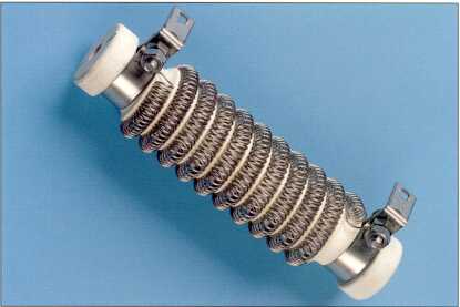

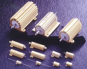

Sorry but I'm Portuguese and I don't understand the translation of "wirewound"...

'Wirewound' is a resistor made from resistance wire wrapped around a former, and usually coated in ceramic - it gives a high wattage resistor, far more so than small carbon or metal film resistors.

A picture says 1000 words... These are wirewound resistors.
