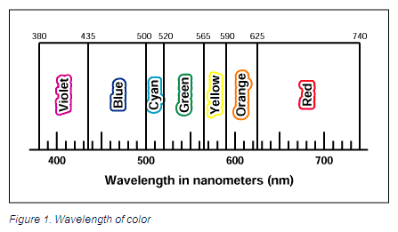

Of course the advertisment is wrong. It is written by marketing money-grabbers and not by engineers. Blue isn't 415nm, that is in the middle of violet which is next to UV. A violet light gives plenty of UV. Maybe it doesn't have any UV and really has blue, so nobody gets blinded by UV.
Get a fluorescent tube fixture and put red and blue color filters on ordinary white tubes. Theater supply companies have the acetate filters that slide onto the tubes.
