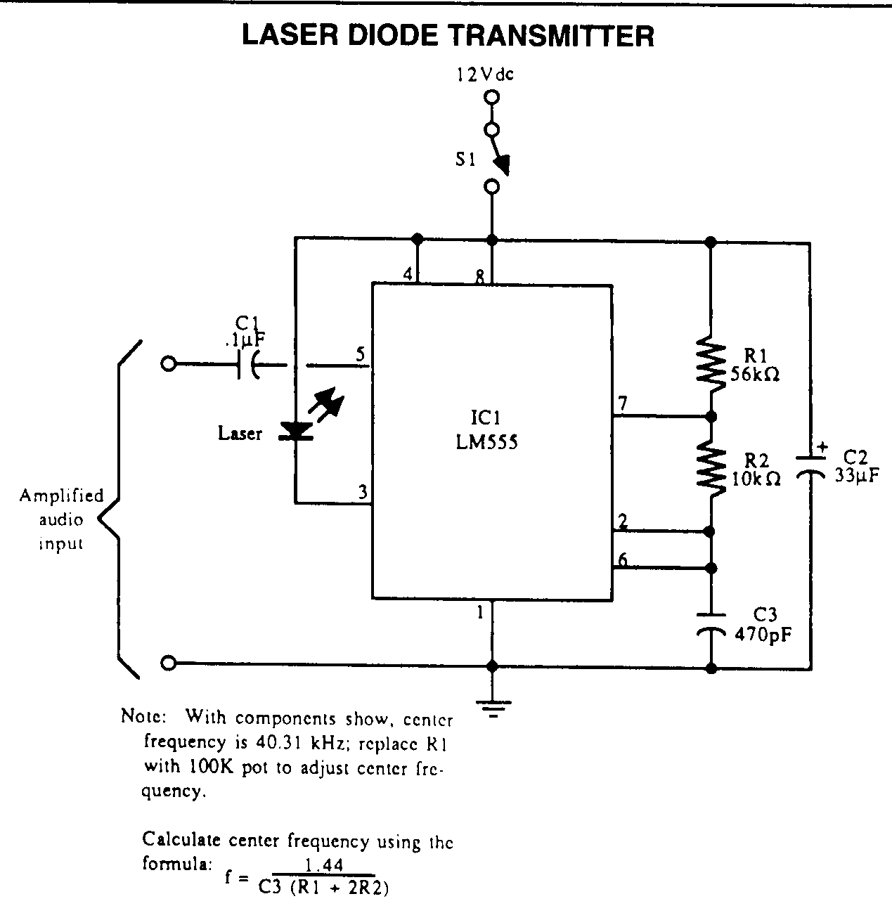

I found a circuit of transmitter on the Net which below, but no receiver was there.
Any one can help me,
it's out put is train of pulses, how can i convert them back in to audio.
Please guide me in this way.
Any link, any pic, tutorial that can help me plz.

An ordinary "safe" laser diode from a pointer will probably fry in that circuit because it doesn't have any current-limiting. A laser diode that can survive the high current is probably the "unsafe" kind that blind people.
The circuit is the pulse-width-modulation circuit from the datasheet for the LM555, and it uses a 40kHz carrier frequency. many receiver circuits on the web use infrared instead of visible light and are an AM receiver for the 40kHz signal.

A simple lowpass filter is a PWM demodulator for that simple transmitter.
