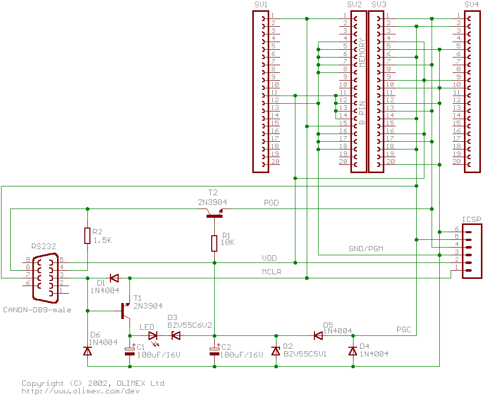

Those files below are my PG2C programmer, built from PG2C of olimex. It works good with ICPROG
The 4 diode next to the db9 connector is 1N4007, and the 2 zener near the socket is 6V2 and 5V1. R = 1.5K and 10K. Everything is same to PG2C, but I rotate the socket to easy to push and pull out the PICs.
Transistor = 2N3904, 2N2222, if you use C1815, notice the pinouts, but it's oki.
Sometime, it may work with laptop, but I don't think is good, because the laptop only generate 11.7V from VSS to MCLR. I said sometimes! That is it cannot work frequently.!!! But everything is oki with desktop.
ICPROG support most of chip. But as you will see the Nigel programmer is very good, and I recommend you to use Nigel programmer.
A vietnamese friend who studying in Australia once say somewhere in this forum, his teacher recommended that everyone who learn to PIC, first have to get Nigel programmer himself.
You can use Nigel programmer with ICPROG = PROPIC2.
Oh, sorry, I don't know, I upload again here.
And downthere is also the ORCAD files
There are 8 linkers in the pcb. It's because I don't want to build thin lines that may troubles some who make pcb themselves.
Note that the diode should place as
__________
2| | |1
2---|<|------1
not
because the layout from scheme file make pin1 and pin 2 of diode from + to - And the nearer line show pin1
You can use ORCAD to move the components closer to make smaller board, but I don't care muchie of that, because I would like a large board enough to fix it on a plastic rectangle disk to protect soldered nods.

Huh? which diode? I am all confused now since I am a noob. Do you have a parts list and a picture of finished project? Please help this noob.
PS. Besides, what is the difference between yours and the one I mentioned originally?
