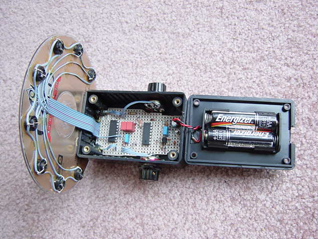

Most of the previous replies are for perforated board, not perforated stripboard where half of the printed wiring is already done for you by its strips. I have even made huge and very complicated high-speed logic circuits on Veroboard and they worked just fine and lasted "forever".
I plan a circuit layout on gridpaper, then cut the strips with a light touch from my drillpress. I use the srips for horizontal runs (IC pins) and jumpers, resistors and capacitors for vertical connections.
For example:

hey audioguru that is really neat. i also like the 3V chaser you made (www.electronics-lab.com)

Thanks Sam,
My new 6V Ultra-Bright Chaser project runs the LEDs for a few revolutions then stops with the LEDs off for a couple of seconds to save battery power before starting again. The same circuit also works for a 3V Chaser with a few parts changed. I turned-down the flash duration to 15ms so the Ultra-Bright LEDs look like fireworks and also to save battery power.
