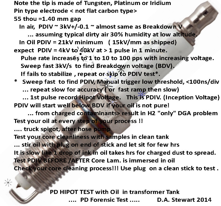

FYI An extremely purified transformer oil is capable of >50kV/mm which can be reduced to 10kV/mm easily for example to the untrained user. Air is ~ 1kV/mm depending on RH% from flat smooth surfaces. So when they send samples for DGA analyis (dissolved combustible gas analysis) they always use very clean glass containers. Typically oil must pass 35kV/mm. It will have an odor that is hard to get rid of, so seal all containers. Get the oil part number and read the MSDS as well. Invisible dust, moisture particles measured in ppm will reduce the BDV thresholds in oil testers due to tribo-electric effects in the dielectric and DC charge buildup resulting in 25~50% reduced BDV or breakdown V thresholds. I have personally verified this. Invisible Iron core dust in oil is even worse for PD effects.

- spark plugs are usually 25mil but you indicated 125 mil or 3.1mm thus 314 V/mm indicates sharp needle or dirty air and high RH would be consistent with your results.
- 15kV in 3/4" or 19mm is 790V/mm is also consistent with sharp points or wire and not flat smooth or large round surfaces.
What voltage arcs at 1/64"? (0.4mm)
Poor BDV is consistent as I said before with contaminated samples (non visible) If you can not get >10kV/mm then very contaminated sample. Industry expects >25kV/mm minimum
- polyethylene is capable of 19 - 160kV/mm depending on quality but drops rapidly with rising T and is poor for thermal conductance.
I have performed hundreds of different tests. and one like this with a needle plug in air and compared with transformer insulating Oil (NYNAS)
< mechanical shock induced arc
Other tests I have performed include up to 200kV AC and DC dielectric tests.
If you need info, I have some experience.
