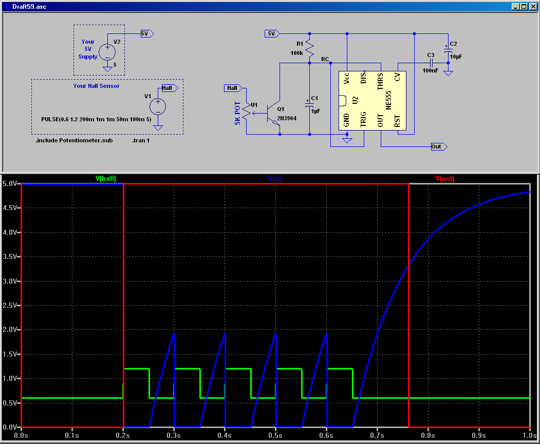

You should download LTSpice and start using that. It is INFINITELY better than any port of Berkley Spice because 99% of the convergence issues have been fixed. It has a huge user community. It is totally free.
Typical LTSpice run: The 555 model in this sim is a "behavioral" model. However, a transistor-level model is available.
