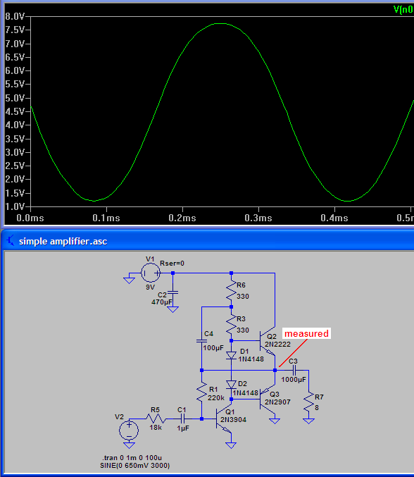

The difference is probably in the type of amplifier. Linear amplifiers are like linear regulators, they eat up a lot of power that does not get delivered to the output. We could go through the math if you like. But a switching amplifier uses PWM to get much higher efficiency because it does not have to loose much power just to create a sine (or audio) signal because it creates a synthesized sine using pulses that are either on or off but no in between.
A little arithmetic shows what power supply is needed for a speaker to produce 3W.
If the speaker is 8 ohms then the maximum RMS voltage into the speaker is [the root of (3W x 8 ohms)]= 4.9V RMS.
The maximum peak-to-peak output voltage is 4.9V x 2.828= 13.9Vp-p.
An audio amplifier output has a few volts of voltage loss so the power supply must be about 13.9V + 3V= 16.9V.
If the speaker is 4 ohms then the current in it is double the current in the 8 ohm speaker so the maximum peak-to-peak output voltage is half but the voltage loss is a little more.
The maximum RMS output voltage is [the root of (3W x 4 ohms)]= 3.5V RMS.
The maximum peak-to-peak output voltage is 3.5V x 2.828= 9.9V.
The voltage loss will be about 4V so the power supply must be about 9.9V/2 + 4V= 9V.
I have seen thousands of amplifier circuits but I have never seen one with a micro controller.
Here is the schematic of a simple audio amplifier that uses only 3 transistors. With a 9V supply and an 8 ohm speaker its output power is 0.9W. Its power can be higher with a higher supply voltage or a 4 ohm speaker but the transistors must be selected for higher currents.
Because it is simple its distortion is noticeable by some people.
