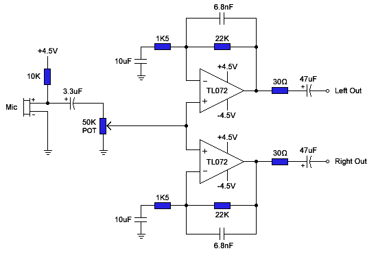

I went hunting to find out if I could locate something earlier and found this?
Poor design, typical or what.
Thanks for the circuit,
Why it has just one Mike and a left and a right output? If the designer wanted to design a stereo Mike amplifier then He must use 2 mikes not just one? whats the usage of the above circuit?
Besides, those two 6.8nF Caps cause me to think of an integrator op-amp, But as this is not an integrator circuit then whats the benefit of those 2 caps there?
A guy was hacking an old Lamp and using it as a parabolic mic.
This was the circuit he came up with, I just found it interesting because I have some equipment that uses monural for all the sound. Then my mixers can split it and I can amplify it from there if I choose.
It's really just for recording though. Anyhow I saw talk about stereo and monural and thought I would offer it up to look at.

The second circuit uses a reference created by using a voltage divider to make the operating point fall somewhere around the middle of the rail voltage. The dotted line might as well be solid as the bottom left op amp doesn't do much - looks like they're trying to make a differential input. Also note that the output is AC coupled, so it's not as important where the return lead of the speaker goes (you could also connect it to the positive rail - just remember to reverse the output cap as it's polarised).
The 1st circuit doesn't use the resistor dividers as it already has a reference well within the supply rails (i.e. ground). As the input is DC coupled (i.e. no ac-coupling capacitor), the input return lead is connected to ground.
That first circuit is a steaming pile. Has any poor soul actually bothered to build it?
