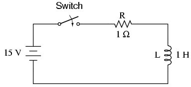

I see that I need learn a little spice, but is a nice programm, I where reading a little and doing simple things, one of this is the switch is posible to place one?, also I will like to know if there is a way tou put 7 segment leds or things like that???? or I will need always to watch at the voltage of x diode??
What I do if I whant a 7490 I need to build the component, for example I havent tryied this, but I think is whit the Hierarchy described in the help file???, some one can provide a example???

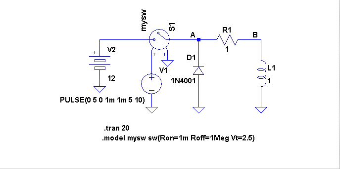

Below is a schematic of how to implement a switch in SwitcherCAD III. I'm sorry I don't have time to address all your other questions.
Here is the .ASC file, which you can copy and paste into Notepad and save it as a SwitcherCAD III file (filename.asc).

TEXT -178 386 Left 0 !.tran 20
TEXT -184 416 Left 0 !.model mysw sw(Ron=1m Roff=1Meg Vt=2.5)

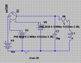

I see, I have beed playing a little ;).

I think I need add a sine wave or some thing for turn it off and on???, or this is fine.
Also I have watched some definitions of symbols and I have watched taht they are defined like a subcircuit in a asc file or sub file or even a lib file (7-zip can open if for watch some files).
There are the definitions of the symbols used.... Now I understand if I whant a 7494 I must "write it" I guess. :)
I guess I need practice more, now I understand that for example, I cant put a 7segment display like in ewb, but I can still have a circuit and check the currents there for see if a led is condusing or not :).
A question, in switcher cad for what is only posible to get Volts when I click in the nodes/wires and if I click in a symbol I can only get the current in this symbol (in the graph)
