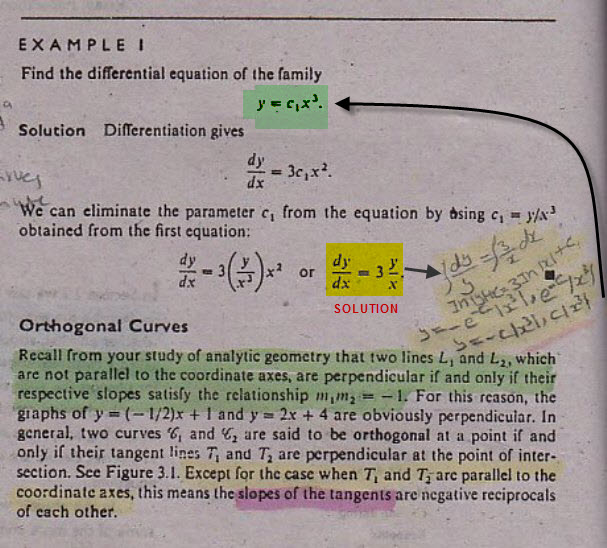

Hi
Please have a look on the attachment. I have integrated the "solution" which is a differential equation to see if I get back y just out of curiosity. As you can see, I ended up with:
1: y = -c|x^3|, or, 2: y = c|x^3|
The original form was y=c1*x^3. So which form should I use, "1" or "2"? I think it's "2" because the original form didn't have a negative sign "-". But what about the absolute value? Please help me with it. Thanks a lot.
Regards
PG
Hi
Regards
PG

Hi MrAl
Both solutions, 1: y = -c|x^3|, or, 2: y = c|x^3|, satisfy the differential equation, dy/dx=3y/x. I started with y=c1*x^3 (let's call "3") which is also a solution to the differential equation in addition to "1" and "2". But when I integrated the differential equation I only ended up with "1" and "2", there was no third solution. Isn't there any difference between y=c|x^3| and y=c1*x^3? I think there is. Please help me with it. Thank you.
Best wishes
PG

You started with
dy/dx=3*y/x
and change the form to
dy/y=3*dx/x
Then integrate both sides
ln(y)+C1=3*ln(x)+C2
so
y=x^3*e^(C2-C1)
Your solution is correct but you see it requires x>=0 because In(-ve) isn't defined. That's why I used abs values in the highlighted line. Please let me know if I'm thinking a long the right lines. Your solution is exactly the same as "3" and this is what I had at the start of the problem. Were my two solutions, "1" and "2", incorrect where I used abs values? Thank you for the help. It has been very kind of you.
Best regards
PG

Not sure if this will help:
ln|y|+C1=ln|x|+C2
|y|=C*|x|
Thank you, MrAl.
For the original problem, these were the solutions I came up with: 1: y = -c|x^3|, 2: y = c|x^3|, 3: y = cx^3.
For "1" and "2", we can write: y=(+/-)c*|x^3|. As "c" is a constant, therefore "(+/-)c" could be written simply as "c". It becomes: y=c*|x^3|. If we simply assume that x>=0, then it could further be written as: c*x^3.
I'm sorry if I'm speaking nonsense. Right now I'm really sleepy. :(

Hi again,
Yes! And so you end up with two solutions anyway :-)
So, "are we done yet?" (that's also the title of a cool movie too)
Absolute value signs are great to get rid of if possible. Can we eliminate them?
Hi MrAl
As they say there is no end to pursuit of knowledge! :) So, I'm not sure if we are done yet!
By the way, I have checked out the details of the movie "Are We Done Yet?". I don't know how I missed it. Although there are two remakes available of the original starring Cary Grant, whenever I get time I'm going to watch the original because I have always liked Cary Grant. You might like Bringing Up a Baby.
I don't really know how to get rid of absolute value signs. I can only think of two choice and not sure if they are correct; you either use a piece-wise function, or restrict the value 'x' over the interval x>=0 then it makes |x|=x.
Many thanks for the help.
With best regards
PG
Im in a little bit of a hurry right now, so why dont you try to define it in two piece wise functions and see what you can find out. It's interesting i assure you :-)
Hi again, MrAl :)
Here it is:
So, what this means is that we have only two solutions: y=-cx^3 and y=cx^3. But can't we just replace -c in y=-cx^3 with +c? This would mean we have only one solution?
With best regards
PG
Yes, isnt that interesting? c*x^3 covers (of course) c*x^3 solutions with c either plus or minus, and it also covers solutions c*|x^3| for c plus or minus.
Pretty amazing i think.
This is kinda pickie stuff i know, but take heart, in real life it's a little simpler to figure out what works and what doesnt once we get some kind of physical situation.
