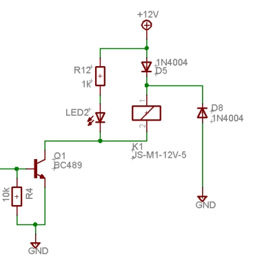

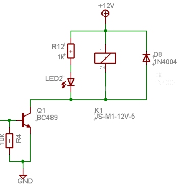

Look at the 2 diagrams below - My basic query is "which one is correct?"
I think that Circuit #2 is correct becuase the circuit #1 will cause osculation of the back-EMF when the relay is turned off becase the current cannot escape to GND (directly) and hence will have to be disapated in the relay coil.
Whereas in Circuit #2, when the relay turns off, the back-EMF is shorted directly to GND.
Can anyone confirm for me please?

Hi Kybert,
Nigel is right.
In circuit #1 when the relay coil's current is suddenly halted by the transistor turning off, the collapsing magnetic field in the coil will generate a reverse voltage across it, but is limited to about 0.7V by the diode. Therefore the collector of the transistor is protected from the very high positive voltage that would occur if the diode wasn't there.
The back-EMF doesn't have to be conducted to ground, it just needs to be reduced in voltage, which the diode across the coil does very well by conducting.
In circuit #2, the back-EMF will cause a very high voltage across the coil, with terminal 1 positive and terminal 2 negative. Since nothing conducts to hold terminal 1 to any reference voltage, current will not flow through either diode. The high voltage may arc across the coil.

I just ran a sim on circuit 2 (for what it's worth). Both ends of the coil fly positive, with a very high voltage damped oscillation on terminal 1. I used a 10mH - 20mH inductor with 50 - 100 ohms of resistance, paralleled by various capacitors in the range of 10pF - 100pF. The interesting thing was that the peak voltage on terminal 2 is apparently held by the capacitor(s), because, in the sim, the voltage on both terminals settles rapidly and holds flat at several hundred volts, the actual value depending on the capacitance, inductance, and resistance of the coil. Not an intuitive result, at least to me.
Of course, most transistor and LED models don't include breakdown voltage, so these values would be clipped, and devices would probably be damaged.

But why use two diodes and do it badly?, when you can use one diode and do it correctly!.
Where did you invent the scheme from?, I've never seen anything like it before :lol:
I didn't know how to do it correctly...
That's the point of my question, i was trying to firuge out what is happening and what i need to do about it,
Now i know and can move on to my next problem..
