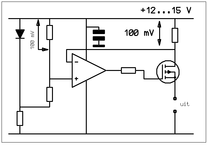

Hello all,
I remember, there was some problem when using opamps with their inputs near
the supplyvoltage.
I now have a cirquit, I hope I can post that too, where the inputs are at +supply - 100mV.
Could I use any OP, or is there something to consider ?
The OPs should not be too expensive, bcs I need a lot.
Kind regards,
Edwin

Why dont you adjust the values of the components in order to bring the inputs within the operating range of standard OPA's.?
Hi Eric, thanks for the very quick reply.
It is used to charge a second battery in a car, and when I go lower, it will not get charged.
Now I should get the 2nd battery up to some 200...300 mV below the main battery.
Edwin

Most OPA's as may already know dont make 'good' comparators.
A comparator like the LM393 etc, will not work reliably at Vin > Vsup -1V.
There are opamps that work "rail-to-rail" rather than within two diode drops of V+ and V-. If you can find an online "selection guide" they will probably show these types.

The cirquit should prevent `short-cirquits` when the 2nd battery is completely flat.
Any relay would burn away, with, say, 200 Amps, when you connect a flat battery
to a charged one.
This cirquit is meant to keep the current to a max of 5 or 6 Amp.
Regards,
Edwin

You have the drain and source of the P-channel Mosfet connected upside-down.
The source is supposed to connect to the resistor and the drain is the output.
Many FET-input opamps like the TL071 work fine when their input is at the positive supply voltage because their FETs are P-channel.

I know, re D/S, in real the FET will be connected the right way.
It is only the wrong symbol I used in the diagram. Sorry, should have told in the first post.
No, it is not possible to lift the 2nd battery from ground, I already thought about it.
I think I etch 1 PCB, and try the circuit with different opamps, starting with the mentioned TL 071.
There is a much easier circuit with only 2 transistors, but that has a drop of at least 1,5 Volt.
That is why I thought of this one, with the opamp.
Thanks !

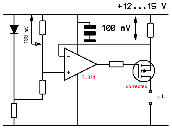

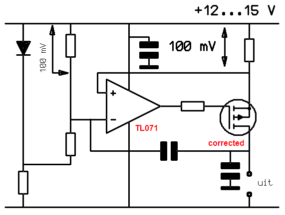

The + and - pins are the wrong way round, there's no compensation so it will oscillate and there needs to be a capacitor on the output to improve the transient response.
Sorry, but the inputs are correct.
The reference is 100 mV below supply.
With no current through the FET (and the sense-resistor), the voltage on the - input is the
same as the supplyvoltage, so (100mV)higher => the output is LOW => FET is complete open.
(Watch it, it is a P-FET, symbol is upside down, as mentioned in a previous post)
As soon as the voltage over the senseresistor becomes lower than the reference, the output
goes higher, to close the FET.
Kind regards,
Edwin.
EDIT:
You're right, the input pins were the right way round and I messed it up.
You still need a compensation capacitor though as P-channel MOSFET has gain so a compensation capacitor is required or it will oscillate. You could avoid the discrete compensation capacitor by making the gate resistor a high value and use the MOSFET's gate capacitance as a compensation capacitor.
No problem, re messing up... :) It is sometimes very confusing.
First, it `hangs` on the positive supply instead of standing on ground, then using an
inverting amplifier.... Sometimes the brain doesn`t co-operate with it :)
And than... in my poor English.... I wrote `open` FET where I meant conducting and vise versa.
But an OPEN switch is NOT conducting....
I was planning to make the gate-resistor about 1...10 kOhm.
The gatecapacitance is mostly around 2 nF by this kind of FETs.
So, a bit extra is no problem. buckets of 0805 100 nF `in stock`.
And when this is ready, the next problem, that I did not work out yet, is `measuring` the
voltagedifference between both batteries. If < 0,5 Volt, a big relay may be switched on,
to give the 2nd battery the last bit to get charged. :D
Kind regards,
Edwin
