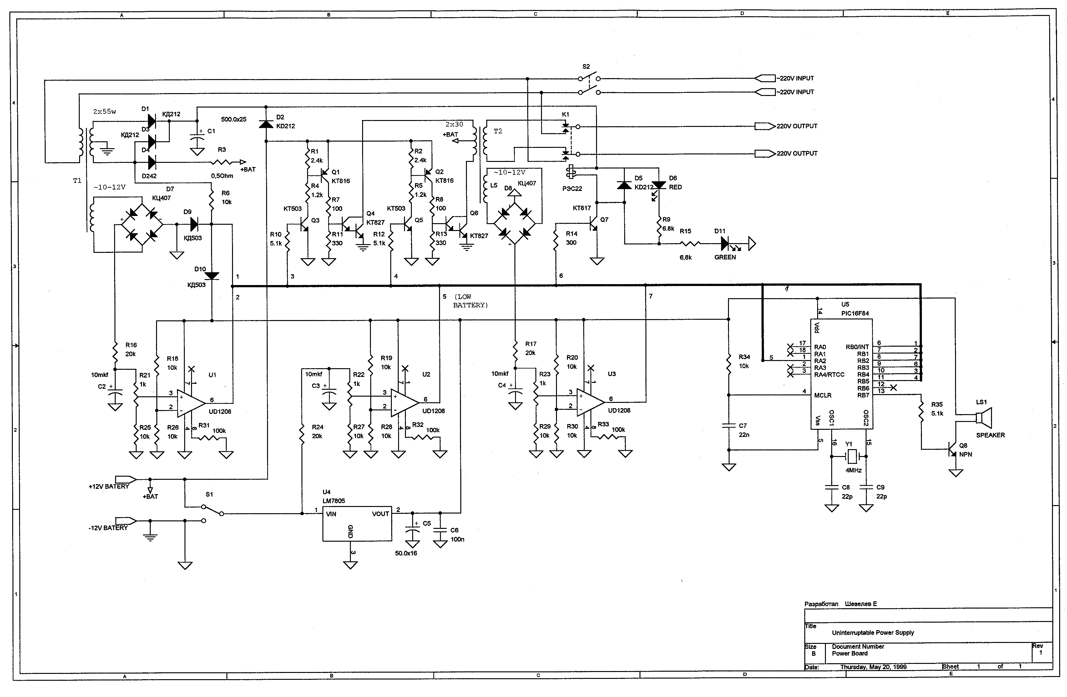

Hi All ;
I Want To Program This Circuit And I Want To Use Pic16f877 Not Pic 16f84 So ...
See The Schematic ...
And Reply Me Please
battary monitor .. how to do that , and if you see the schematic you see that only analog is battary

Why would you want to change it to a 16F877? A 16F628 would be a better match. Also use code tags and it would be helpful if the comments were in English.
