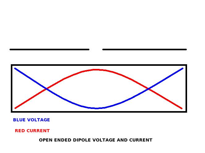

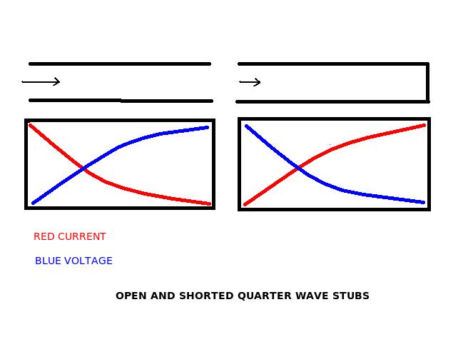

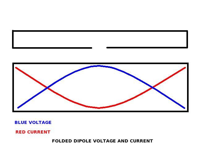

i was asked whether paralleling 300 ohm antenna elements would yield a lower impedance. the short answer is it would raise the impedance. i wont go into as much detail as my original answer, but suffice it to say that a 300 ohm antenna element is made of two shorted 1/4l stubs, and a 50 or 75 ohm antenna element is made of two open 1/4l stubs, paralleling shorted stubs RAISES the impedance towards infinity, and paralleling open stubs LOWERS the impedance toward zero.
the first drawing shows how the voltage and current are seen on open and shorted quarter wave stubs.
the second shows the voltage and current distribution on an open ended dipole. the fact that the current is high and the voltage is low at the feedpoint means LOW impedance.
the third shows a folded dipole and the voltage and current distributions on it, the voltage is high, and the current low at the feedpoint, so this is a high impedance.
paralleling quarter wave stubs only makes them more efficient at what they do, so paralleling two open dipoles would bring the impedance closer to zero. paralleling folded dipoles would bring the impedance closer to infinity.

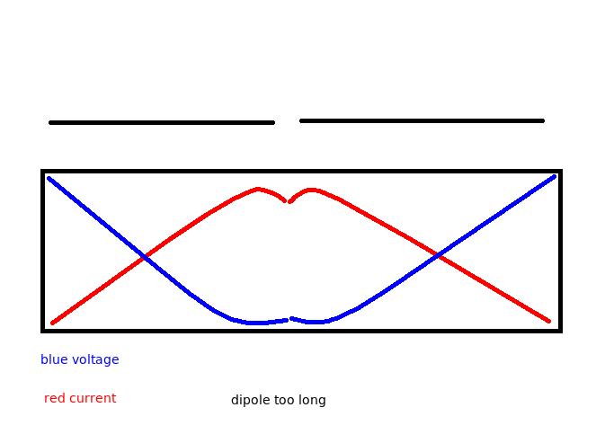

i don't know if modern editions of the ARRL handbook show using lamps like that to measure current and voltage in antenna, but some of the older ones did. the incandescent bulb method used a loop of wire parallel to the antenna to pick up current readings, and a neon bulb to sense voltage. a few years ago when i was in the Army, i was on a field exercise, and was working with a track crew setting up their radio. they weren't receiving anything, and so thought they might not be transmitting. i pulled a neon bulb out of one of their intercom boxes, held it up next to the antenna cable and keyed up the transmitter. the bulb lit up very bright. they were up on the air, but had a problem with the receiver antenna relay. i ran a separate antenna to the receiver and they were back in business. nobody, not even the guys from the radio shop had ever seen that trick before (the NCO of the track crew had me demonstrate that again when the radio tech got there...)...
as for determining whether an antenna is too long, there would be a voltage minimum near (but not at) the feedpoint if the antenna is too long for an open ended dipole, and it would be a current minimum for a folded dipole. for an antenna that's too short, you would never reach the minimum current or voltage, since it would be higher than normal beginning at the feedpoint and rising from there. antenna impedance is a complex quantity, consisting of capacitive and inductive reactances that should be equal values at resonance an open ended dipole is equivalent to a series resonant circuit, and a folded dipole is equivalent to a parallel resonant circuit, antenna analyzers measure the balance between capacitive and inductive reactances at the frequency of interest, and can tell you instantly whether the antenna is short or long (as well as the impedance and SWR)
to clarify a bit, the reference for the current and voltage curves is set at the ends of the antenna, not at the feedpoint. if the antenna is an open dipole, the current is zero at the end of the antenna, and the voltage is maximum, and the relationship between current and voltage working back to the feedpoint is a function of distance from the open end. same holds true for a folded dipole, except current is max at the end and voltage is zero. a full wave dipole (each leg 1/2l) would have (ideally) the same voltage and current at the feedpoint as at the ends because the phase relationship is now 180 degrees instead of 90 degrees, the "standing waves" are "reflected" from the ends, not from the feedpoint.
I'm not really sure what you are saying. If you take a two resonant half-wave dipoles, impedance about 70 ohms each, if you mount them almost touching and parallel the terminals then you still see about 70 ohms. It will act like a fatter dipole.
In the case of paralleling folded dipoles you mean creating a dipole with two parallel elements instead of one, (a triple folded dipole) then this increases the impedance by a factor of 9. You can also get different impedance multiplications by using varying diameters for the two arms of a folded dipole, see here for example
