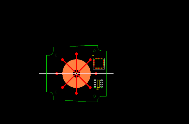

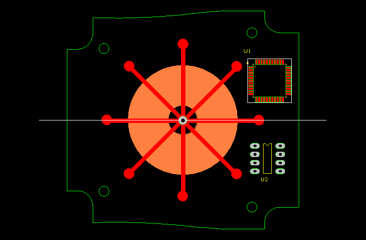

I have a case that requires a PCB with arcs. I'm having a hard time choosing a package, but I have looked at a few of them.
Two problems:
They make it look like it's easy until you have to draw a package. That's where most of the design software sucks. You seem to be drawing blind.
DXF import. It's tough to have a particular PCB (assume one with arcs) line up with a plastic case. You have to get all of the fiducials right.
Here is the challenge: Design a PCB with this case https://www.electro-tech-online.com/custompdfs/2013/08/145311290456668164.pdf where the penetrations to the case are not symetrical.
DXF files are available.
I have been using DesignSpark for pcb creation lately. It has the DXF import feature which I have found critical to create arc shape copper pours, solder masks etc.
I start off with AutoSketch to create the radius shapes, array patterns, and geometry, then export as DXF file. Importing the DXF into DesignSpark then reassigning the individual elements to Board, or Top layer etc. is no problem.
Here is the DXF import board challenge with Design Spark.
very nice:
I still had trouble creating footprints. Diptrace wasn't too bad for footprint creation. Target looks like a pretty nice package, but again it like creating footprints in the dark.
