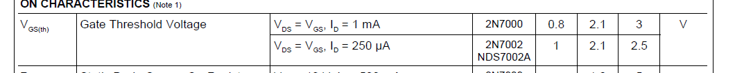

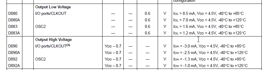

I used a 2N7000 years ago on a 12F509 to run a relay. No problem. But, I had a pull down resistor on its gate. Since his output is staying low, maybe the input needs a pull down, if his source is high impedance. In other words, the input pin may not be toggling as planned.
Have you scoped the input at the pin? Or, substitute just a resistor for the mosfet?
I believe John could be correct, the Vgs and Vlow are very close.
