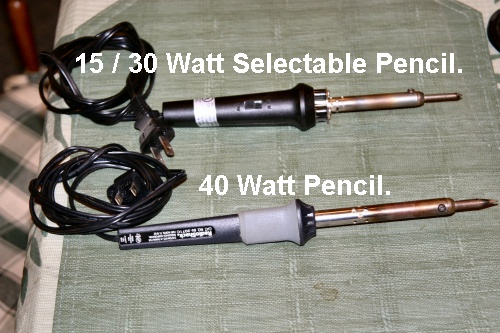

I have a solding pencil it is too slow it takes a while for the part to heat up so solder will stick. I have bought factory soldering gun tips they are very slow to heat up. It took me 2 hours to replace and repair the wires with several packages of new alligator clips and new wires. If I had used a slow factory tip it would have taken three times longer. Those factory tips take about 20 seconds to get hot enough to solder, my homemade tip is hot in 4 seconds. I have a 75 watt and 100 watt soldering iron I could have used one of those but they are too big for this job.
Gary, I have been using Weller and similar soldering guns just like these for well over 40 years. When I pull the trigger I get heat and I get it well within 5 seconds well in excess of the 500 or so degrees needed to melt average diameter 60/40 solder. Most such guns have a two stage trigger as can be seen in the link and even at stage one heat quickly. What diameter solder are you using and what is the solder composition?
As to bending AWG 10 or AWG 12 wire the actual bend forming the tip will be larger than the marketed tips for any standard gun sans the large guns using a heating pad type tip.
As to using a pencil. Yes, a pencil takes a few min to heat but a 30 watt pencil Like the one attached in the link when using the correct solder diameter of about .031" the solder melts and flows quickly for each job as in maybe 5 to 10 seconds per joint.
Aside from the El' Cheapo pencils there are nice controlled heat stations out there which have become relatively inexpensive and they attain temperatures in excess of 500 degrees F in less than a min.
Also attached is an image of a 50 watt resistor terminal soldered to a bare copper AWG 12 wire that was part of a load bank I built. Using the attached 30 / 15 watt pencil I soldered dozens of those junctions in a few hours tops averaging 10 seconds per solder joint.
So I guess I don't get it as solder must melt and flow different in OH. than TN.
