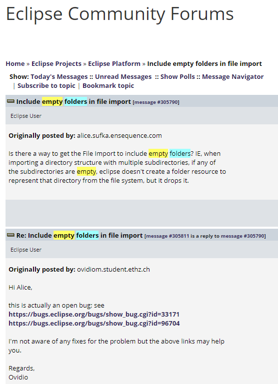

This might be a problem with eclipse Import Wizard because dragging files from the file system and dropping them into one of eclipse navigation views works. Empty folders are imported.
This is bug in eclipse. See attached.
