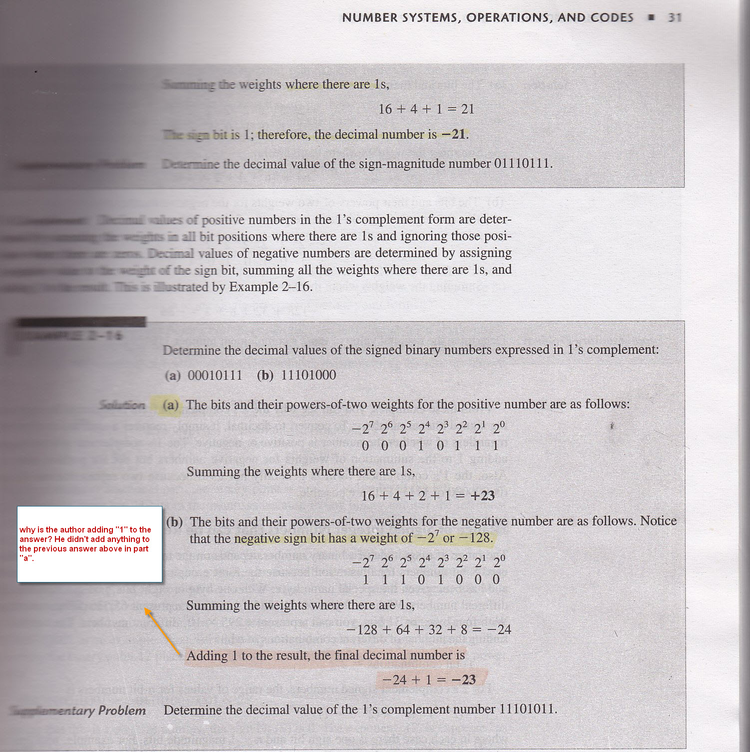

why is author adding 1 to the answer?
PG1995
Active Member
Hi
Please check the attachment. You can find my question there. Thank you.
It looks like that's because the number is negative, while the previous number was positive.
It looks like another way to compute this when the number is negative is as follows:
11000
where the leftmost bit is the sign bit and this number is negative, you take the right 4 bits:
1000
and that equals 8 decimal, so the number is -8. Pretty simple that way.
This means zero can be represented as 00000 or 11111.
Positive 8 would be 01000.

You mean to say the negative of a 2's complement number. You cannot tell just be looking at a binary whether it is 1's or 2's complement. It is a matter in interpretation. It also affects the way you add or subtract the numbers. With a 2's complement, you don't worry about the end-arround-carry. You can also get the negative of a 1's complement by just inverting all the bits.
To prove that -14 is 11110010, and it to +14 (00001110)
and you will get 00000000, and the carry bit will also be set off the most significant end of the byte.
I think that just about makes sense!
Yes, and for 1's complement, 00001110 + 11110001 = 11111111, which is zero for 1's complement. Remember that 1's complement has two representations for zero.

FF = 1111 1111 = 255
How can you say that "1111 1111" would equate to zero?
FF, or 11111111, is only = to 255 (decimal) if you treat it as an unsigned 8-bit number. Unsigned numbers can only have positive values (the "sign bit" is just part of the number).
For negative quantities we need to use signed numbers; as defined by one's complement, FF = 0 (because remember, there are 2 values of zero in that system, 11111111 and 00000000). In two's complement, it's -128.
