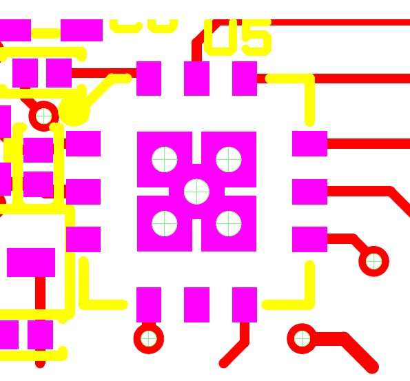

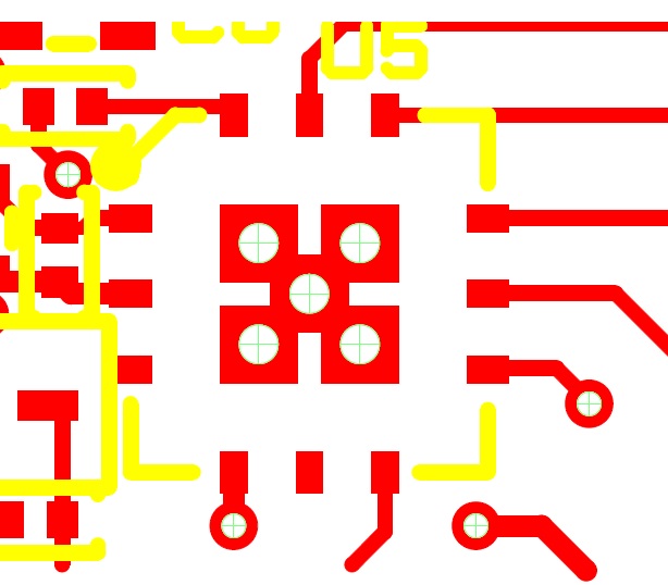

Our PCB layout engineer has placed five thermal vias of diameter 0.65mm in the thermal pad of our DT3001 IC. (as in the jpeg attached).
he seems to have just used five square PTH vias, which as you can see , dont fit together very well and hence there is solder resist between them. Is this bad?
So has got solder resist over the thermal pad. (as attached)
Surely 0.65mm is way too big for a thermal via in such a small thermal pad?
(he has made the thermal pad 3mm x 3mm)

I don't like your middle pad. Changed it to a square. (pink)
Then added more copper under the part, on all layers. Bring out the copper on the top layer to close to the pads. On the other layers it could come out much bigger.
On the bottom right corner; this is how I would do all four corners. (red)

That looks like a really good thermal pad design. The DT3001 IC is an offline LED driver IC, and there is mains voltage going into its pins, I just wondered if the clearance from centre pad to outer pads was being kept at 1.025mm because of the voltage? The DT3001 datasheet doesn’t say which pin (if any) that the centre thermal pad is connected to…but implies that it should be left floating.
Though if there is solder resist over the outer edges of the centre pad then that eases the clearance concern?
Also, is there any concern that having any solder resist under the 6x6 area of the IC might hold it up off the centre thermal pad and prevent effective soldering to the centre thermal pad?
I think the solder past is thicker than the solder mask. (resist)
If there is high voltage on a pin then keep the copper back away from the pad.
If a part is hot, I use very thick traces. Traces as thick as the pad, to help pull heat out away from the part.
Thanks, and you would agree that 0.65mm diameter is way too big for a thermal via, as in the above?
