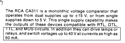

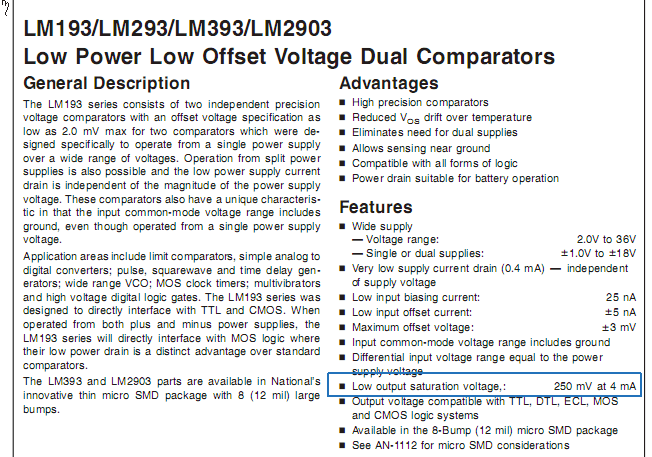

The LM311 is faster, and with the strobe pins shorted together, faster still.
Aditionally, the input/output characteristics of the LM311 are more flexible. For instance, the input can be biased with a supply of +/-15 volts, yet the output can be GROUND REFERRED.
Go to National.com They invented both devices, and their spec sheets are very informative.
This is an important difference, if the output requires to sink 50mA the LM311 can do that, the LM393 cannot..
