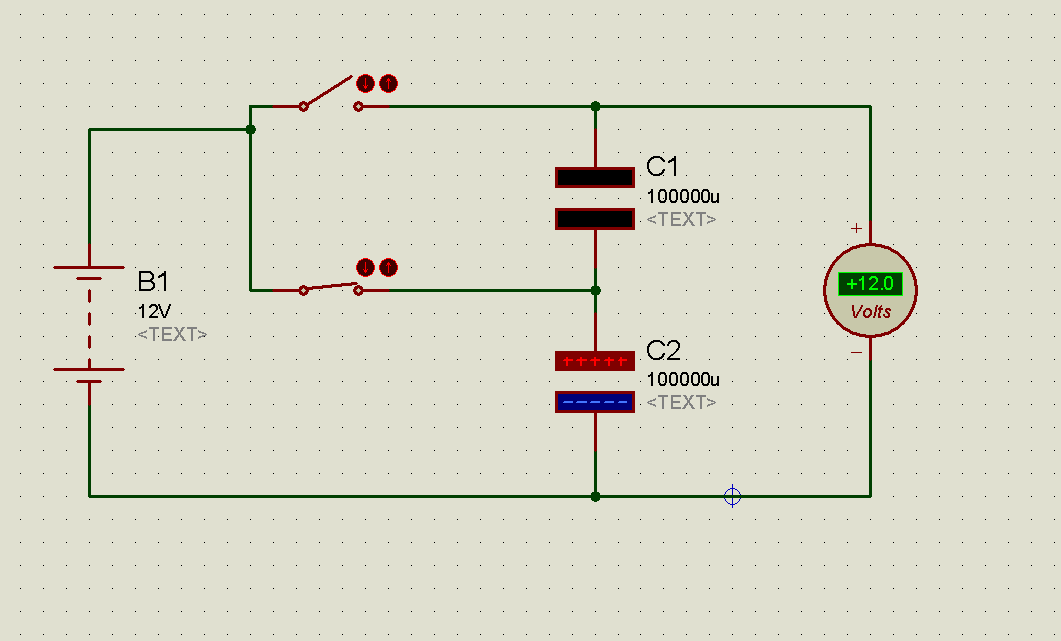

Why the voltmeter Shows this?
Electronman
Why the voltmeter shows 12V while the above SW is open And was open before( I never closed it!)?

Does not make any sense to me!
Is C1 in a closed circuit so that we could say that at t=0 it is shorted? is it able to reach to 12v too at infinite times?
The voltmeter in your diagram is not real. To make it real, place a 10MΩ resistor across it.
Then it will begin at 12V then decay to zero.

What do you mean really?! If it is not ideal so why the circuit is closed at place of C1?
I read 10.5 volts by my multimeter in real when the source voltage was 12V???!
What is t=0 charge on C1. Answer, 0vdc. It takes some load from voltmeter to charge it to -12 vdc so there will zero volts across meter.
Most all transient simulation programs start simulation with zero volts on caps. Your battery current would be near infinity at t=0 to charge the bottom cap. Some sim programs may abort with error for this.
If you want to talk real world, for a 10 meg ohm DVM, it would take over 50 hours for the DVM to get from 0 vdc to a reading of 10 vdc once battery was inserted. (this is assuming 100000u means 0.1 farad).
You have also discovered why you never want to leave a CMOS input of an I.C. open.
