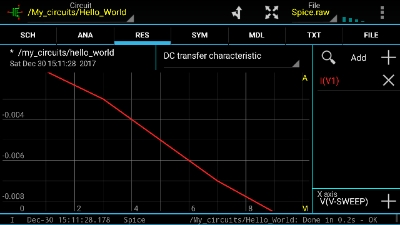

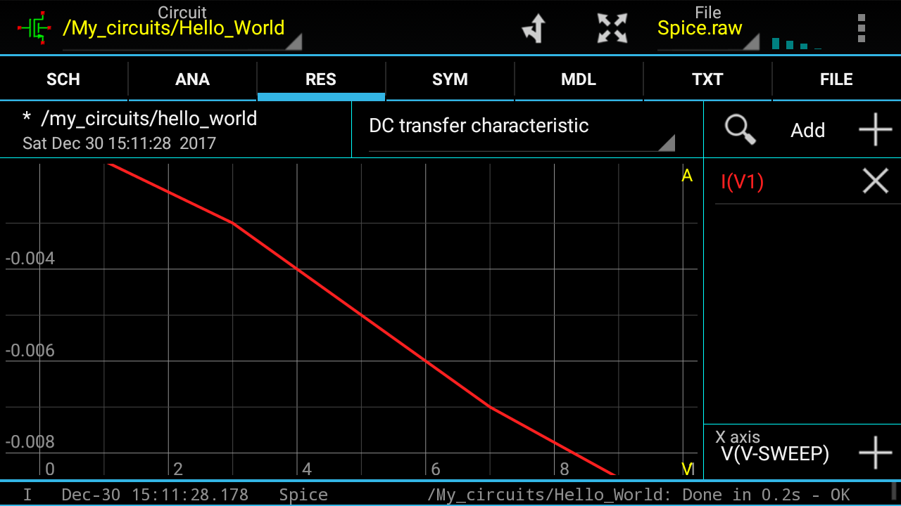

Why this curve is going down? Why the current is negative?
sr13579
Please take a look at the graph and tell me what is wrong? Why it is going downward.
I use this mobile app to simulate the circuit.
Is there anyone who use this app?

The circuit is simply a 9V battery with a 1k ohms load resistor.
The sweep might be the voltage in the battery dropping and the "curve" is the resulting reduction in the current of the circuit.

I agree with the AudioGuru. A sweep function takes one (or more) values and shows what happens if that value varies. In this case it looks like the battery is "swept" from 0 to 9 volts. I think this is not the function you want. Sorry I don't know this program.

The graph slopes down because the current into V1 is negative and its magnitude increases as V1 voltage increases. Spice shows current direction as into a component.
You have a window "DC transfer characteristic". I think you want a different option there.
Now you are plotting "V" against I. Where V changes from 0 to 9.
I think you want "DC ?????". I don't know the exact words. DC something. There should be a place for entering time. "0 to 100mS"
It isn't a fault that needs 'fixing'. It's a Spice feature.

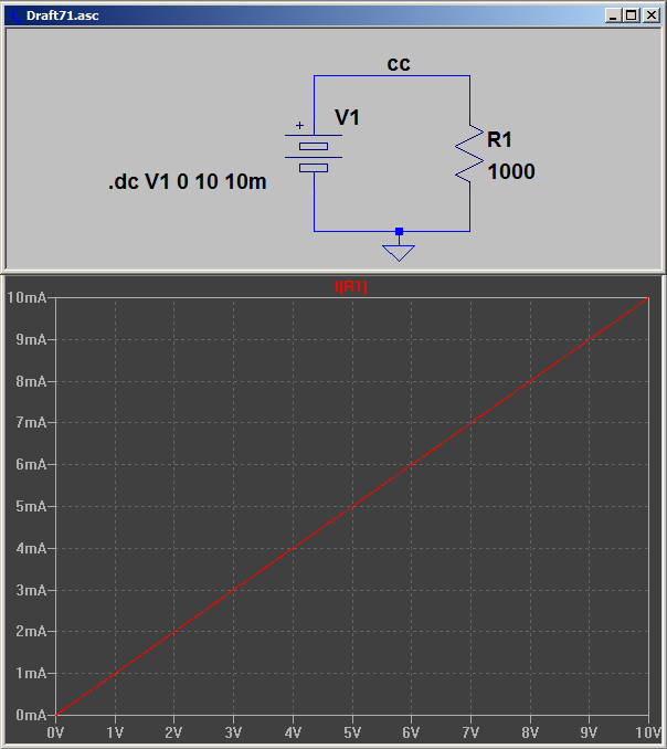

On LT Spice, and others, you can change "I(V1)" to "-I(V1).
OR
On other spices, you can change "I(V1) to I(R1). OR -I(R1) This way you are plotting the current in the resistor. OR negative current.

The red line has two kinks but it should be straight. It is correct at 3mA and 3V across the 1k resistor up to 7mA and 7V across the 1k resistor. Below 3 and above 7 the red line is wrong.

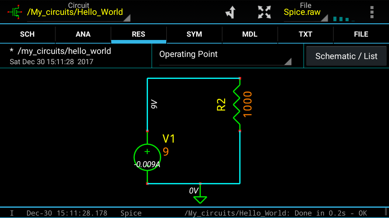

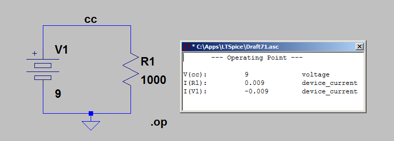

It is a static circuit. You can only do an .OP "operating point" analysis on it...
If you want to see what happens if you change V1, then use a .DC sweep. It plots the independent variable V(V1) on the x-axis, and the dependent variable(s) I(R1) on the y-axis.
The current through R1 [I(R1)] is positive by convention. If you apply KCL to the circuit, which way does the current through the source V1 have to flow? By convention, when a source is delivering current to a load, it is a negative current. That is the way engineers (and Spice) work...
