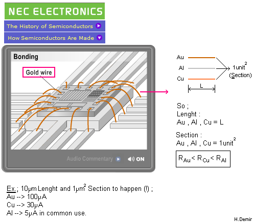

Why Au , why Cu or Al not use.
Roff said:
OK, that's too cryptic for a simpleton like me. Why did you post that equation in this thread?
For example ;
Edit:Fig. in :mu: m
Also ;
If , this IC's make Cu or Al use ,
Wires is to have more section required.
This is IC's impossible Nano Technology or Micro Technology.
