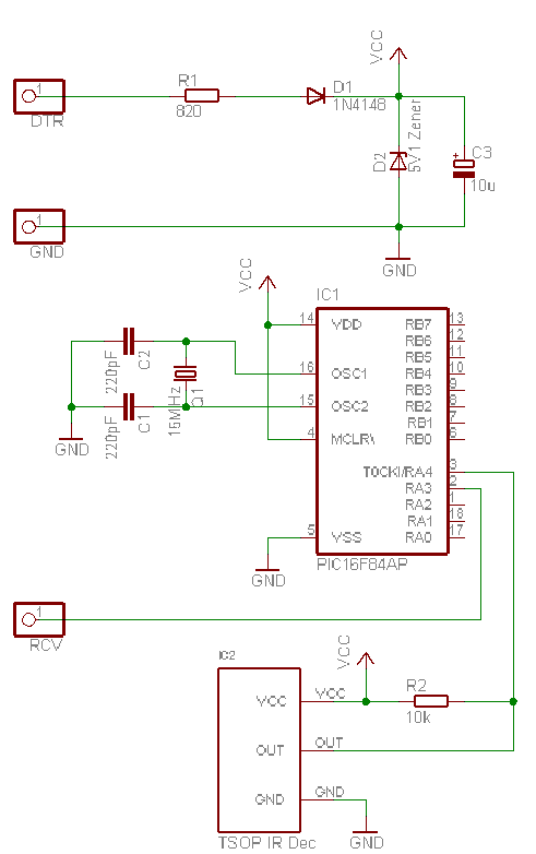

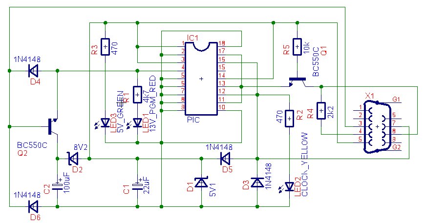

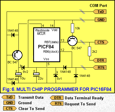

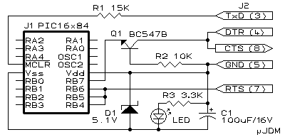

hi i'm new to PICs and
I want to learn how to Program a PIC16F84A
and For the first step i would like to build a PIC Programmer
i have search Google and Yahoo For schematics of PIC Programmer
and found hundreds of it...
i would like to know what PIC programmer is the the most reliable
from you experts Of PICs
Here are some PIC Programmer that I found:
A comment on Each PICs is Very well appreciated
