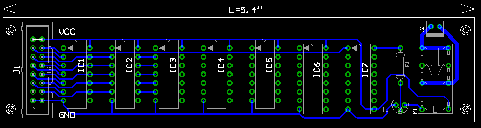

I guess you won't need an explanation paper about wider supply traces. Take a look at the attached sample PCB and decide what all other ICs will do if relay K1 pulls in.
Boncuk
