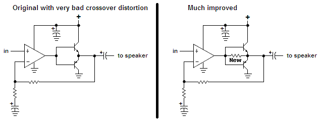

I installed Korean telephone systems for a few years. They had the worst soldering I have ever seen. Customers complained about buzzing in the speakers (crossover distortion from a class-B amplifier) so I added one resistor to pass the audio from the driver to the speaker and it worked perfectly.

Hi again audioguru and Jony,
OH yes very nice. It effectively bypasses the transistors i guess. Lower level output perhaps, but cleaner.
