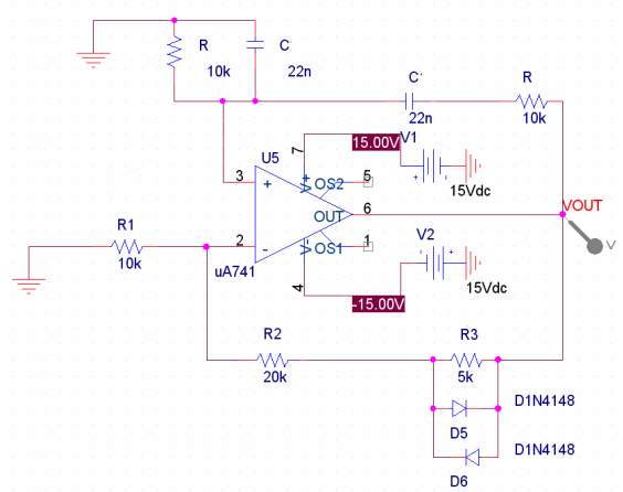

what is the output voltage for this wien oscillator circuit ?
is it V0=3Vd/(2-(r2+r3/r1)) ?
but i have a negative V0 !!!!???

Hi, simply build this circuit and measure Vout voltage.
I long time ago use this method
Vp = Vn = Vout/3
Vout/(3R1) = ( Vout - Vd - (Vout/3) )/R2
Vout = ( 3 • R1 • Vd )/( 2 • R1 - R2 )
Where:
Vd - diode forward voltage drop
Vp - voltage at non-inverting input
Vn - voltage at inverting input
But I never check this equation in real life.

so if i want to control the amplitude ,,, is R2 must be variable ???
why the current doesn't flow through R3 ???
could you explain more about the above circuit
Adam2014,
Are you asking if charge flows from the output through R1 and R2 and R3? Yes, current exists through all three of those resistors. The larger R3 is, the more the OP-amp will amplify. It has to amplify enough to sustain oscillation, but not so much that it will make the output larger than the voltage sources of the OP-amp can accomodate. Therefore, when the output becomes too large, the diodes start to conduct and partially short out R3. This reduces the amplification but still sustains oscillation. Any questions about the theory?

Hi Adam,
The approximation for Vout is:
Vout=3*Vd*R1/(2*R1-R2)
but there are restrictions. I think Jony was the first to mention this equation.
R3 is not in the equation because it is not a significant gain factor. It's just there to make the diode curves a little softer so we get less distortion due to any clipping action. It is in parallel to the diodes so the diodes do most of the control and R3 just helps the diodes do it in a less abrupt way. If on the other hand we had cared to include the diode equation itself in the formula for Vout, then we would certainly have to include R3 in the analysis because we would need it to show exactly how the diode curve changes because of it's value. In the approximation however the diode (either one) is viewed as a voltage source, not a resistance, so we dont have to consider R3's value because it has no effect on the voltage source. Of course R3 can not be too low though, or it will swamp the diode action and we will no longer have any gain control.
The equation is developed from knowing the transfer function for the positive feedback loop and the negative feedback loop. When the circuit oscillates it oscillates at w=1/RC and that means at the non inverting terminal we get a voltage that is Vout/3 and it is in phase with Vout as well. For a perfect circuit, the negative feedback loop would produce Vout/3 at the inverting terminal and this is the basic idea behind the equations, except for the fact that we have diodes (a voltage source) in the negative feedback loop as well. The diode voltage subtracts from the output and that in combination with a tiny offset in the op amp itself produces a non zero output voltage that rises with time until the diodes start to conduct.
The restriction is that R2 can not be too large or there wont be enough feedback and the output will keep rising until the op amp output saturates, and that will cause intense distortion. So R2 has to be kept high enough to allow oscillation to start but still low enough to prevent the output from going too high. This brings us to the schematic which does not look right because R2 looks too large. It may have to be decreased to maybe 15k or 17k or something like that, but you can use the equation to investigate this further.
BTW the diode approximate voltage drop for this kind of circuit may be closer to 0.5v than to the usual 0.7v sometimes associated with a regular si diode.
Please let us know how you make out with it.

i design this circuit for change frequency between 25-50 Hz and amplitude between 2-10 volt
although i do the conditions (R2> 2R1)&(R2+R3/R1>2)
it delay about 100ms to start oscillation ???
when I use it in pwm just the sine-wave circuit (wien) didn't oscillate while the triangular do ???
R1=5k , R2=7.5K , R3=15K
for frequency R=300 ohm , R=330 ohm , C1=C2=10 uf
Your value for "R" is WAY too low. Then you are using POLARIZED (?) and inaccurate 10uF electrolytic capacitors?
Instead use 33k/5% for R and use 0.1uF (100nF) 5% film capacitors.
You say it didn't oscillate "when I use it in pwm" then what is its load?
Does the Wien Bridge oscillator have a +/- 15V supply?
