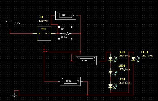

Thanks, i look at your circuit and tried it out. It works perfectly. But lets say if the current source i need is 700ma, use to drive luxeon III leds, i try modifying with your circuit by using smaller R2, the constants current become unstable when i try changing the voltage. Is there i better constants current source to drive a 700ma load?

If increasing the current substantially, you should increase the base current as well, plus use a bigger transistor :lol:
You can use an opamp driving a transistor to make a better constant current source, at the expense of more complexity.

I am not really good in opamp, is there any circuit i can refer to? so i can learn as i experiment with it.
Is it safe to use lm317 to deliver constant current?
