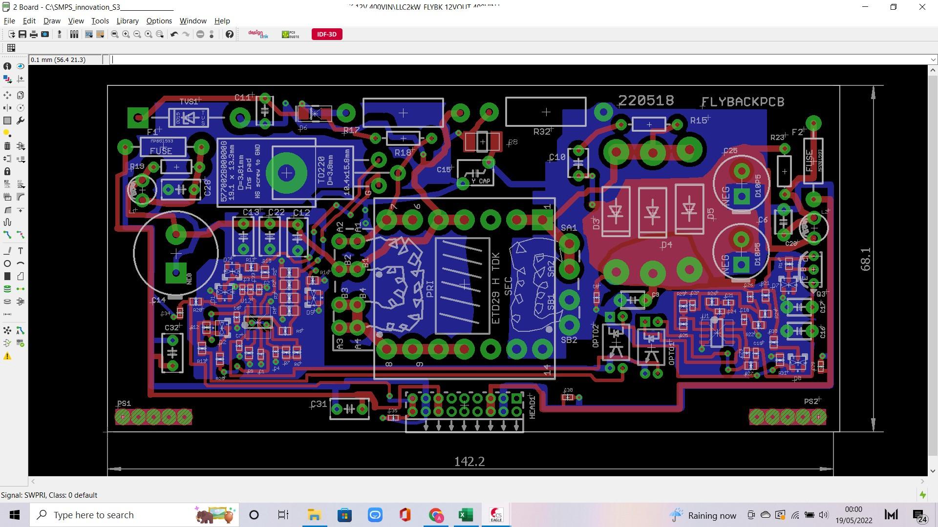

Will the right angled header be OK to hold this PCB as attached?...its only for prototype...never for production...
Its a Flyback SMPS (non isol) with ETD29 ferrite.
Header (right angled)

What an..... um..... interesting board layout. The drunkard's–path routing is something you don't see often.
Thanks....thats a good explanation...just wishing i had a good bottle of London Pride to wash down now.....though look at the electrical viewpoint...perfect layout!...(well, within cost constraints)
I've been into co's where beutiful layout was failing EMC by a million miles, due to poor electrical layout.
But the riddle is, why does a 20way Right angled header not give electrical contact into the mating socket on the main PCB? Is it the stress to the sprung contacts in the housing?

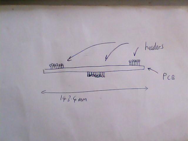

Thanks FTP, for telling about Dis-insertion force...yes, for this reason i will try and use the smallest number of headers.
I may footprint a 72 way, but just use three 12 ways at end , middle and other end, say...and to be sure, i will solder the three sockets in with the mounted header(s) already in them...to get round solder hole size tolerance problems.
What do you think?

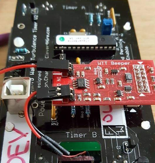

Sorry, I didn't mean to imply that with whatever number of pins, it would be too difficult to remove – just that there is little danger the board will fall out. Unless you're throwing it across the room against the wall.
The red board is supported only by a 1×6 header. About 50 of these have been in the field for 5 years and none have fallen off. Of course, this board doesn't have much mass.
No, I am not suggesting 6 pins or any greater or lessor number of pins for your application – just showing what has worked, since your real-world experience seems to be nil.

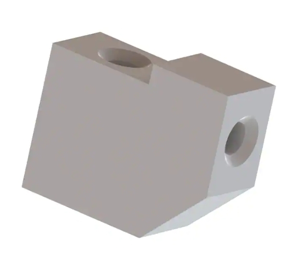

To quell your insecurities and doubters, provision for
one of these blocks
at each end of the board.

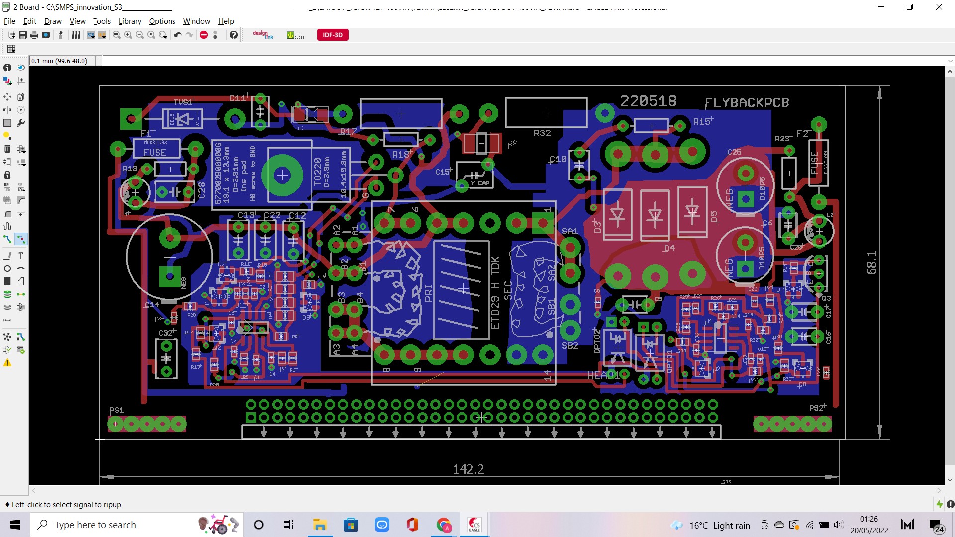

Thanks, just also wondering, what about the attached method?
