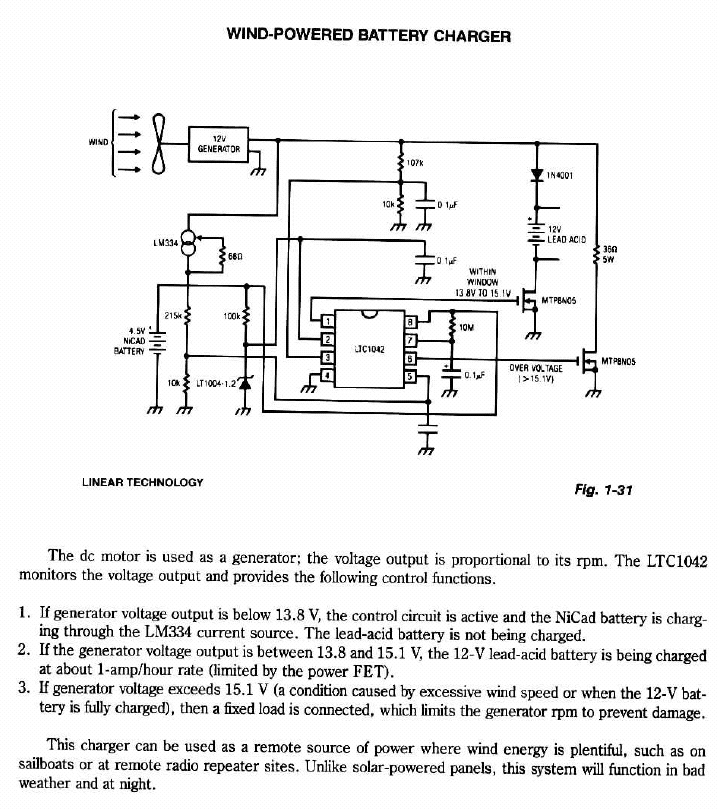

Making the best use of a light breeze that may not provide enough energy to charge a lead acid accumilator by diverting the available charge to low voltage Ni-Cad's. Plus , it also can limit the generator RPM should the need arise.

Sure, as it says voltage is proportional to wind speed and most light breezes won't be able to charge at a high current rate. Why not use the overload resistance to heat water as well, water is great for thermal transfer.
How about using a switching regulator with a transformer that could output 13.8V with the current limited to 1A from a wide input voltage range, like 5V to 20V?
A centrifugal device and springs to change the blade angle at different wind speeds I found was the best solution, you can with a bit of cunning increase the blade area at low wind speeds.
forgive me for my ignorance..but im sorta a newbie..the LM334 is a constant current source right??when buying thecomponent, wht should ask for??jus mention 'LM334"???are all components cheap in this circuit??
yes it is and in the circuit it acts as a current limiter and diode for the NiCad batteries, since the LM334 is limited to 10mA output there would be a better way to recharge 4 nicads but the circuit doesn't need much power so I suppose I'd let that one slide through
if you have 3 phase 100 a 200 volt i assume that you use a normal 3 phase electro motor as generator then you can step it down with a transformer to the prefered voltage (it's AC) and then make the charger for you batteries
this charger will be different as the circuit that is posted in this tread

circuit description
can u give more circuit description. i would like to select this topic as my miniproject.so i needed afew more description about the components and working. what should be the specification of generator?.can u give me further references.
