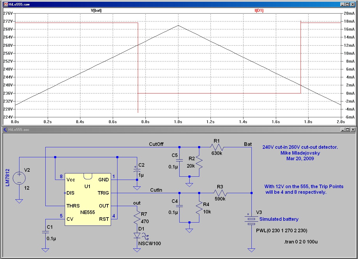

Here you go. I used a LED as a temporary load. You can use a small relay. I would put a snubber diode around the relay coil. If you want it to be ON when the LED is OFF, you can return the other end of the relay to 12V instead of ground. Use a 12V relay with a coil resistance greater than about 100 Ω

Hi Mike,
Thanks for supplying the circuit. I can replace the LED with a relay OK; I'll check it out today and let you know how I get on. I think that the main problem here is that I'm a mechanical engineer and not properly qualified in electronics. I do appreciate your help.
Note that I greatly simplified the circuit just to demonstrate the basic operation. You will have to provide a d.c. power source (wall wart?) of not less than 15V to feed the LM7812. I would put trimpots in the battery sensing voltage dividers so that you can tweak the trip points. I would pick R1 and R3 to be about 10K less than what I showed in the diagram and then put a 20K trim pot in series (center the trimpot at 10K), so that you can fine tune the trip either way...
I noticed that the 555 pin order (cw) as depicted in the schematic is as viewed from the bottom. Pin numbering as viewed from the top of a DIP is usually depicted running ccw.

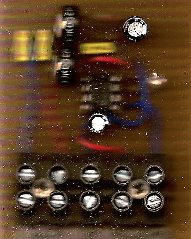

Meanwhile, the circuit from the schematic was been soldered onto a PCB today and is now ready for connection to the system controller for a test! Here though it's nighttime and tomorrow I've got to be sociable with the family; the electronics will have to wait a day for their trial.
I'll get back soon and let you know how I get on.
Some progress but another problem.....
The battery charge circuit has been built using MikeMl's schematic (image attached). So far I haven't added the relay but just the indicator LED, and the output of the 555 goes high when I connect Vcc.
The Vcc is a 12 volt source that I am taking from the existing wind turbine controller; I am also using the ground from the same circuit. However, neither one of the two cables that come in from the battery bank are connected to ground and there's a large potential difference of over 100 volts between these cables and the turbine controller circuit ground. Measuring the difference across these two cables I can obtain the actual battery bank voltage, but how do I tap this value and use it as an input for the charge circuit I'm trying to install? Is it possible or do I need to find an alternative solution? Any suggestions greatfully received. Thank you

Couple of things. First, in my circuit, I assumed that the negative side of the LM7812 voltage regulator is tied to the 555's ground pin. It HAS to be for the circuit to work. Further, I assumed that negative terminal of the battery bank is also tied to the 555's ground pin. It HAS to be, since the 555's comparitors are looking for either 4.00V or 8.00V from the two voltage dividers, so the ground end of the dividers must be referenced to the same ground as the comparitors..
I also assumed that the 12V supply (LM7812) for the 555 is VERY WELL REGULATED, and is 12.00V ± a few mV. I assumed that you would be using a 120V A.C. powered transformer-isolated 15 to 20V D.C. Wall Wart to feed the LM7812. That way, you can connect the ground side of the Wall-Wart to any voltage you want, including the negative end of your battery bank.
If you choose to use your existing 12V supply, you will have to determine if it is ok to tie it to the negative end of your battery bank or not. You will also have to determine if it is sufficiently accurate and well-regulated enough to act as a reference against which the main battery voltage is compared.
How does the existing charge controller measure the battery voltage? It has to be referenced to one end of the battery bank or the other:confused:
The wind turbine controller is an elaborate piece of equipment. It monitors the batteries indicating overvoltage and undervoltage conditions, but it is not a charge controller. Its function is to control the turbine. It doesn't actually show the battery voltage on the display panel; it shows only the charge level coming from the generator. It receives signals from an anemometer and a dogvane and these are used to control a servomotor to keep the generator turned towards the wind.
Inside the turbine controller the PCB connected to the LCD display panel is wired to a power supply with +/- 12 volts, +5 volts and ground as outputs; this source was used for the 555 circuit; it seems pretty stable. The supply also has terminals marked L and N (AC) that give out a signal corresponding to the generator output, somewhere between 230-270 volts. This value goes up and down with the speed of the turbine. The voltage is measured across the two L N terminals and not via ground; it is the same voltage that appears across the battery bank terminals when the generator is turning. The difference between both L or N and ground is over 100 volts.
However, if for example the live (L) terminal is monitored against ground it too will go up and down as the turbine changes speed but will only be at about half the battery voltage. I tried to adjust the 555 circuit to work using this signal but the resistors in the voltage divider dropped the voltage far too low and I thought I'd better stop and ask advice!
OK, I've just been out to check up on the wiring. It's as I said. The red/black wires from the battery bank come in and connect to the terminals in the controller; they then pass to some large black box and then on over the power supply input. I checked with a meter and there's no resistance on either cable so the circuit must be OK. The generator's turning this evening; across LN the voltage was running at 250v; L to ground 110v; N to ground 118v. The batteries are not tied to ground and are being charged directly from the generator.
Is there still any possibility of adding the 555 to regulate the charge?
Sure, just give up on the idea of using the 12V supply inside the charge controller!
Build a separate a.c. powered 12V supply to power the 555 voltage detector. Since it is transformer-isolated, you can tie it to the battery bank's negative and positive terminal without regard as to what is happening inside the charge controller. The 555 voltage detector's output is a relay, so that is isolated, too.

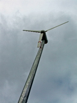

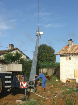

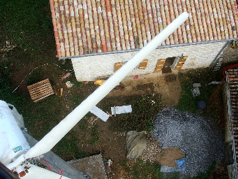

Meanwhile, just to give you a glimpse of the project so far......
How tall is your tower? At least 15 meters my guess.
Also, did you make the turbine yourself or did you purchase it?
Hi Fernando,

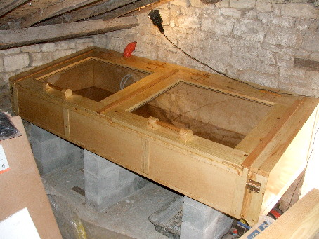

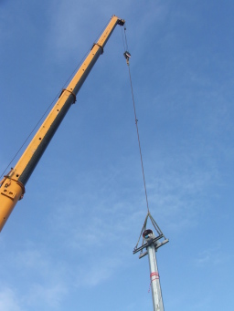

The mast is just under 12 metres tall. Here in Europe there's a limit of 12 metres on the height of the mast. If it's over 12m you need to get planning permission from the local authorities and also permission from the regional authorities because the generator will create "an impact on the environment". If the thing is under 12m you can avoid all this administration.
The generator is 3KW and drives a series of 20 batteries of 200AH. There's a controller that monitors the charge, the wind speed and direction. The wind speed and direction signals are used to control a servomotor in the generator and keep it pointing towards the wind. The circuit will also sense when the windspeed is too high and turn the generator through 90° thus acting as a kind of brake.
There are solar panels to augment the wind turbine output but as yet these haven't been installed (I need to repair the roof on the barn!) The system was purchased from a company called Kingship in China: turbine, mast, blades, batteries, controller, inverter, solar panels, and delivery $10,500
I live in France and I had to pay customs on the import. I have since put the system together myself. A large foundation was dug out for the mast (18 metres cube), a battery box, underground cables, a crane to hoist up the mast, etc. There were several initial problems getting the thing running because the blades weren't properly balanced, and then one had a leak and picked up water causing a further imbalance. Now it seems to work OK and the batteries supply enough power to run the house for four or five days from full charge when there's no wind. The noise is negligible, around 50-55dB.

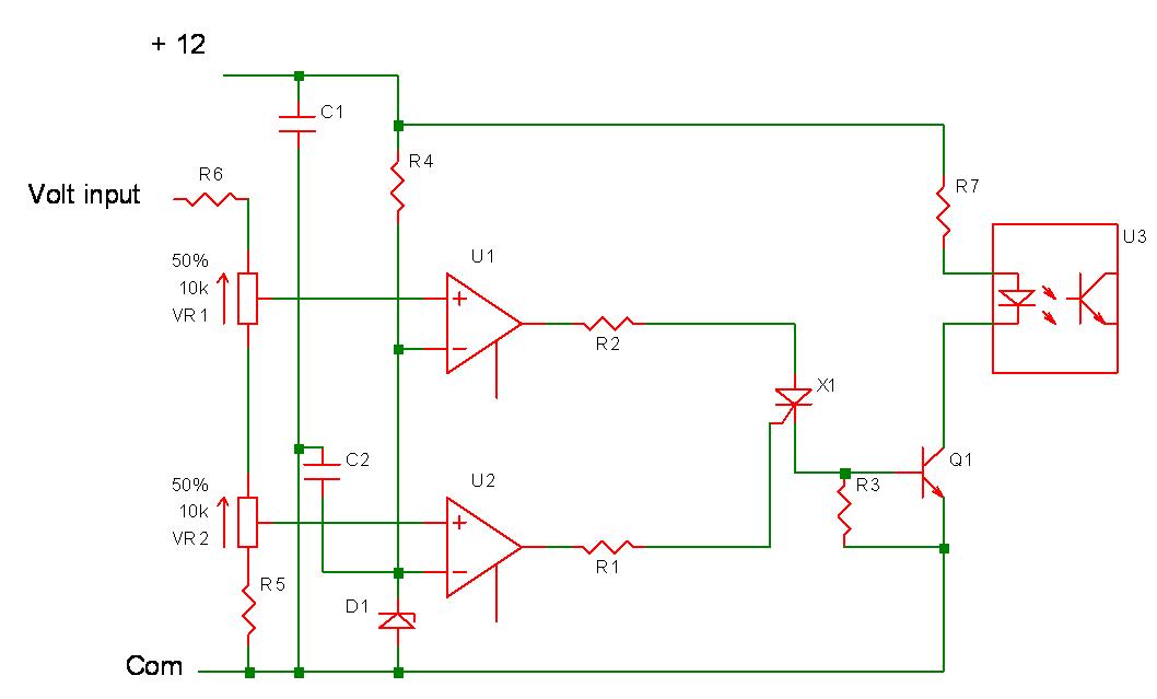

This is a circuit I came up with some time ago. Its great for doing just what you are trying to do. It gives you a high set/low reset window.
I use it on my grid tie inverters to tell them when to connect and disconect based on input voltages.
The opto isolator can be used to trigger stuff or just be ommited if you just want to run the relay in its place.
its not so fussy about its power source voltage either. All you would need to do is put the right resistor voltage divider together for the voltage referance input.

Thanks too for your circuit tcmtech, it was something like my original idea of a window comparitor driving a SCR, but after what's just happened this afternoon I have a feeling the same problem will occur again in your design. The battery input consists of 20 batteries (200Ah) connected in series that will be shorted across the two trim pots in your schematic. Yes, the voltage will be there alright, but there are far too many amps for my liking and I see the thing exploding again. I'm certain both of these circuits would work fine, but how do I tap off a voltage reading to regulate the chip without all that power getting in the way?
As I mentioned in an earlier reply, neither of the battery bank cables are tied to the wind turbine controller ground; there's about 100 volts difference. However, I have tried putting a pair of voltage dividing resistors between ground and the terminal marked 'L'. When I first tried this the 100v dropped to almost zero; I don't know why, but the system continued to function, nothing got hot or started to smoke. The right resistors will have to be selected to obtain a 4v or 8v output but it might be possible to get the circuit working like this. I'm just guessing of course, I'm really out of my depth so if someone's got some sound advice I'd be glad to hear it!
